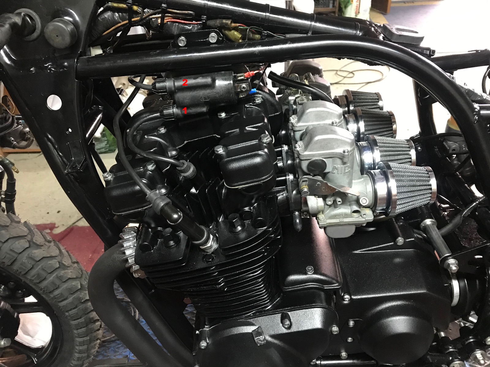

hello
i need help because I'm not sure if the connection is well made.
Can someone confirm me if it's okay?
1-2
2-3
3-4
4-1
best regards...

What connection are you asking about?

the connect coil to cilinder head (spark)

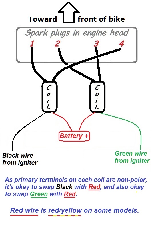

If the wiring is factory correct, the left coil is connected to 1 and 4, the right coil is connected to 2 and 3.

sorry i dont put images but now is ready

hi
this case my images is worng... i need to change.

In stock configuration:
Port-side coil (coil on the left-hand side when sitting on the bike) goes to outside spark plugs;
Starboard-side coil (coil on the right-hand side when sitting on the bike) goes to inside spark plugs.
What are colors of the two small wires that attach to each coil's primary terminals? This will help us to be sure that the signal (trigger) wires haven't been mixed so as to have the left coil fire inside plugs and the right coil fire outside plugs (which will work, but isn't stock).

left side
1 - red
2 - black
right side
1 - red
2 - green
