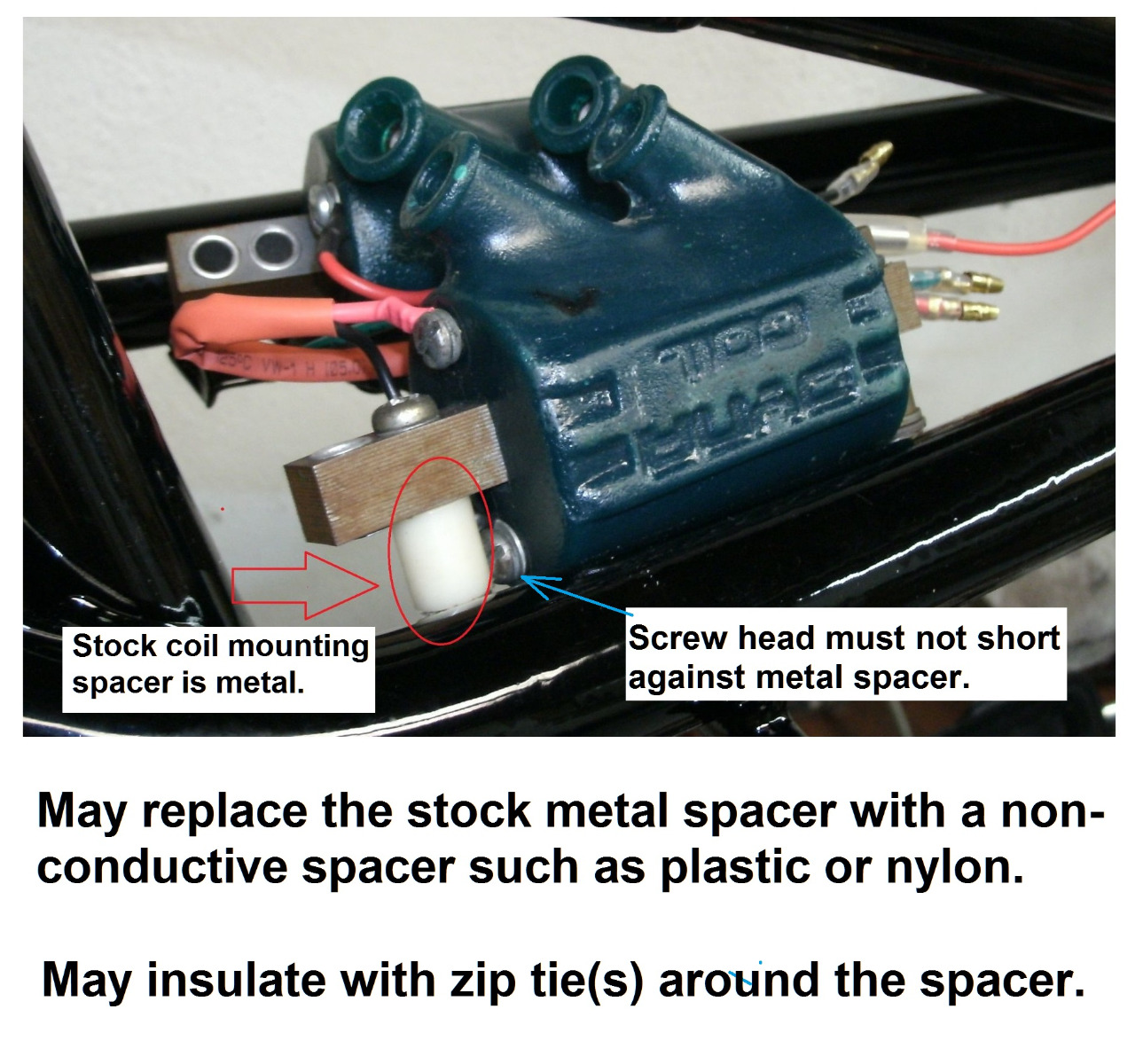

Some motorcycle models have an available switched battery positive female bullet fitting which can be used for an accessory, as does my KZ900LTD which is used to power the Dyna-S.

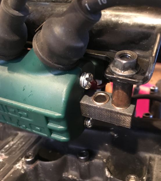

Patton wrote:
Good Fortune! :)
Somehow the previous owner of my Z used the metal spacer with dyna coils with no issue... when I replaced the dyna coils with a new pair, I was unable to replicate his success and wound up using heatshrink wrap over the metal spacer.
Genius idea using nylon spacers!

The metal spacers help to dissipate heat. I wrapped mine with tape.

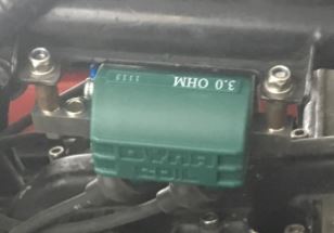

Hemm... I have metal spacer on mine and have not had problems.. I know about :) heh

The positive screw can short on the spacer. I used button head screws but still there wasn't a lot of gap thus the tape.

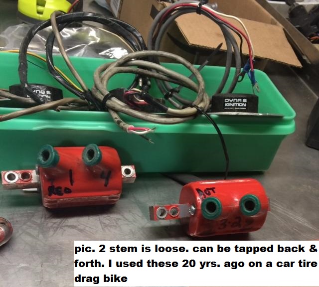

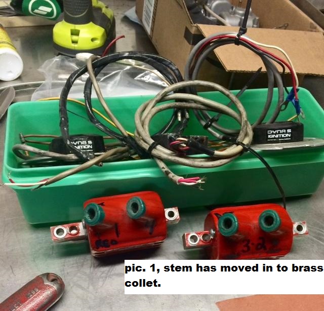

The stem on these DYNA coils must have gotten hot enough to soften the epoxy holding them inside coil. I can slide the stem back and forth.
I used these 20 yrs. ago on a car tire bike.
And DYNA pick ups do blow out with high rev & heat. Got a pile of juck!

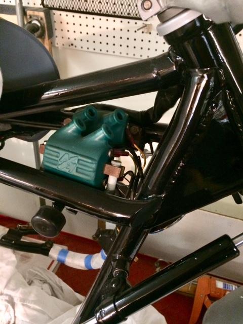

23 Nov 2018 17:13
#794152
I found some picture from my coils, I dont`t think it shall be any problem here?
Looks like I have another angel on the coils towards the frame....
