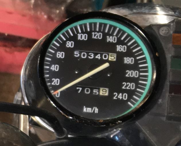

My speedometer is unstable, jumping back and forth approx 10km/h / 6mph... and when I accelerate hard it fan "fly" higher and then come down.
Is there any why to improve these, or is the part inside "wear and tear".
