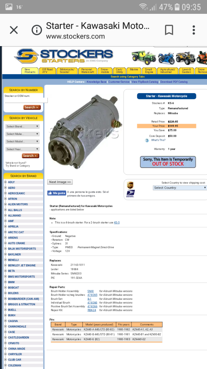

Hi, thanks for reply .
I have doubt about, because in one starter site say CW.
Regards.
Regards.

I rebulid all the motorcycle (complete restoration) The original starte has the magnet broken. I got one used but working. And de doubt is the rotation. looking the shaft turno to de right (CW) .
Here in Argentina is hard to get starter from this model in good condition.
Thanks.
Regards.
