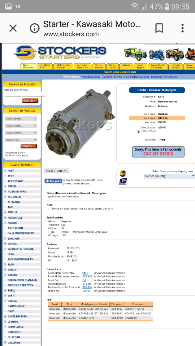

I have doubt about, because in one starter site say CW.

I rebulid all the motorcycle (complete restoration) The original starte has the magnet broken. I got one used but working. And de doubt is the rotation. looking the shaft turno to de right (CW) .
