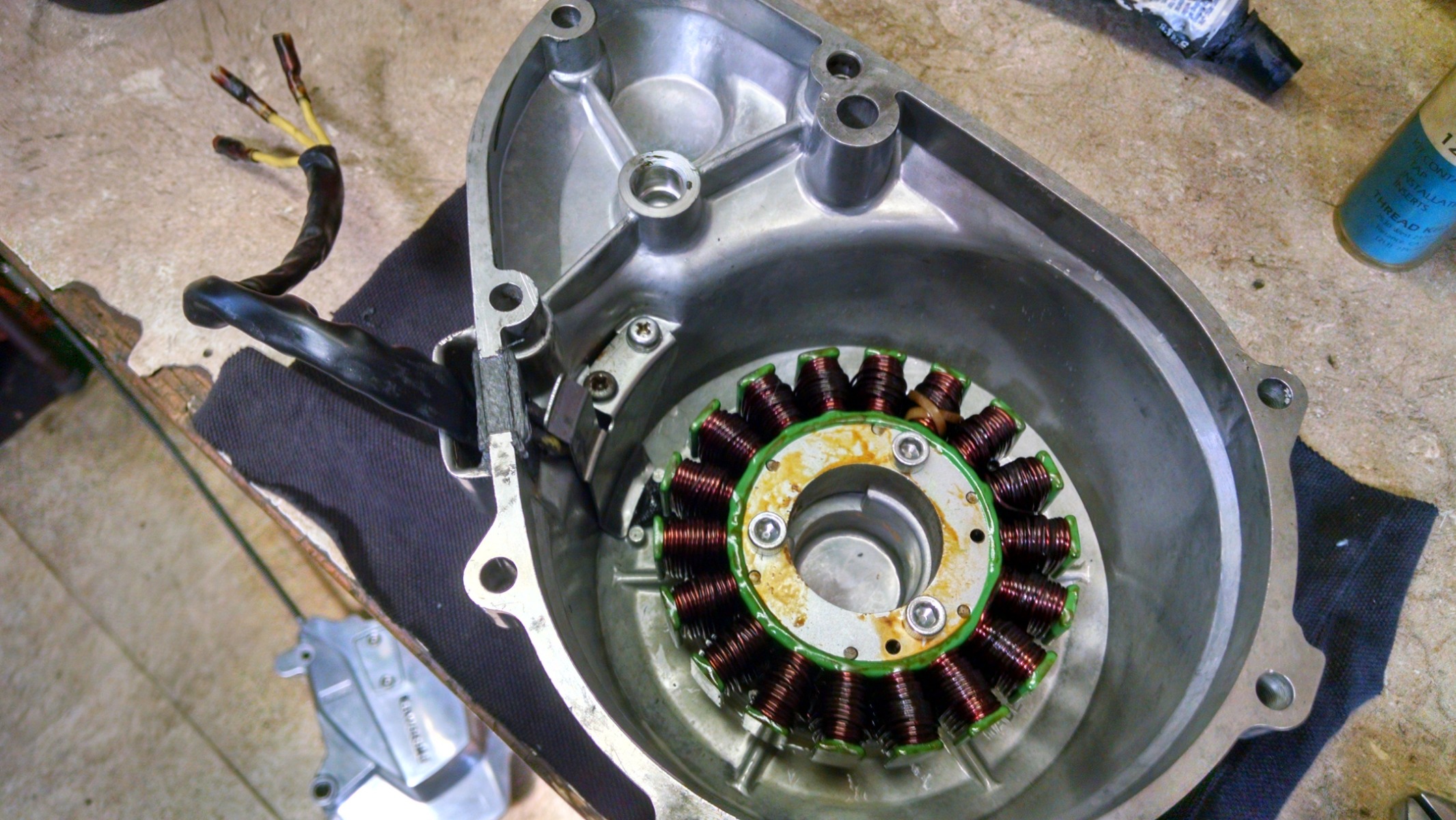

Chinese cheapo stator.. not smoked yet (pic was last week). :-)

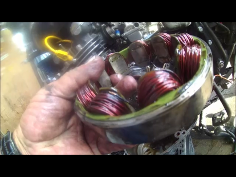

This is want happened when I bought a knock off R/R on ebay. Ruined a brand new stator. :angry:
