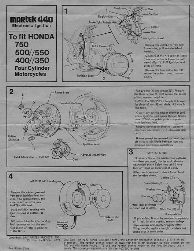

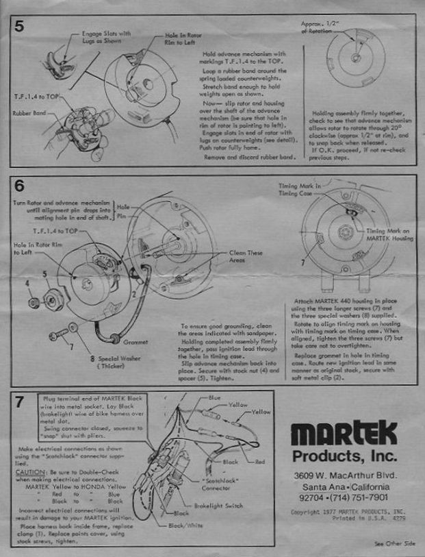

Yes, I believe the Martek 440 put out a longer duration than the points, so the coils would get hotter than with points.
Dyna S is probably your best option. The 4 ohm coils should work great with the Dyna S. Like the Martek, the coils will get hotter with the Dyna S too, because the Dyna S also has a much longer dwell than the points did. 4 ohm coils will run cooler than 3 ohm coils would, so I'd stick with the 4 ohms.
However, a bad igniter would not cause 3 of 4 plugs to spark. The weakness could be a bad igniter, but the missing spark would be a coil or plug wires.
This is all I got on the Martek 440. It's been decades since I worked on one.
