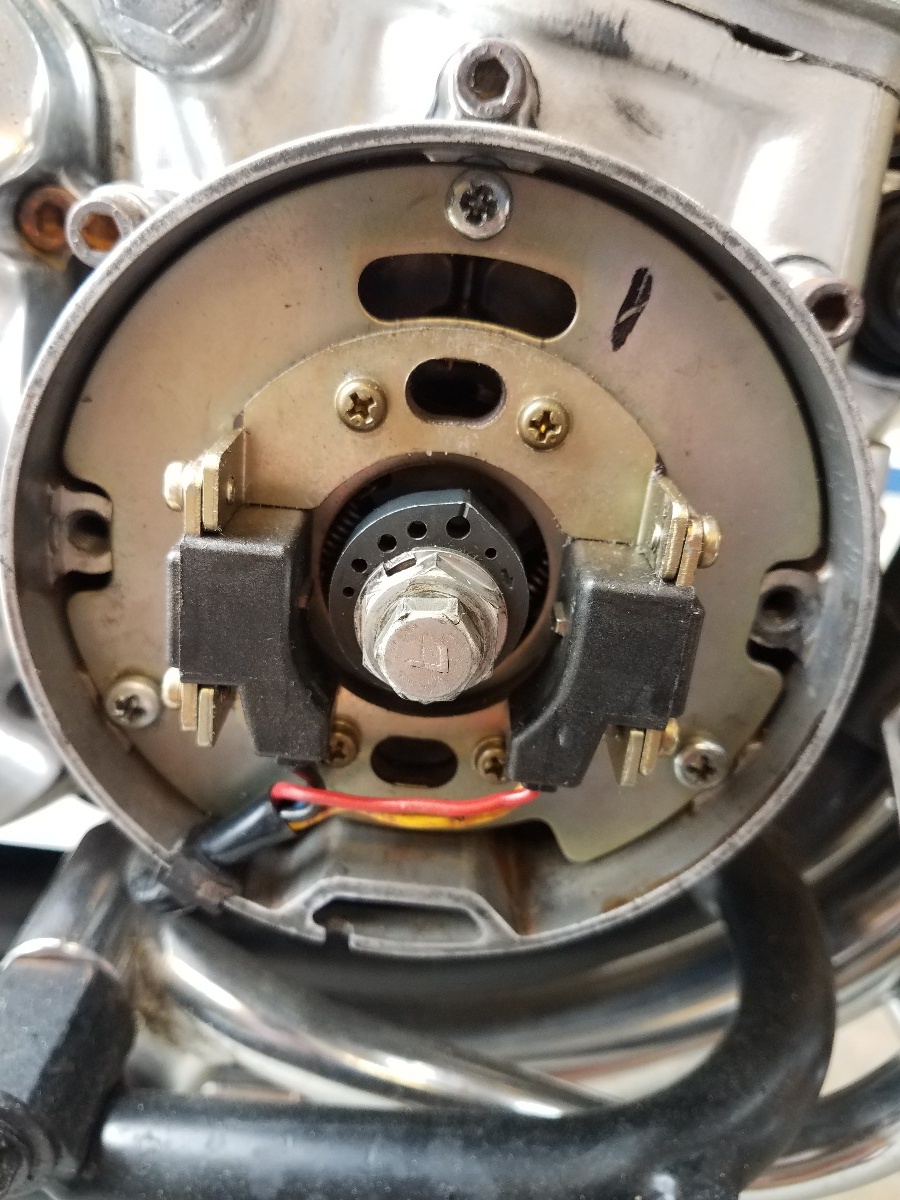

I put my factory coils back on and replaced the ignitor. I had spark in all 4 cylinders but once under way it felt like it was only running on 2. I actually have another KZP that runs great so i swapped the pickup coils and rotor. I took the bike out for a spin and it seemed to run ok now. I then put the pickup coils and rotor from this bike in my other bike and that one seemed to run ok too. This bike is a 2000 my other is a 2002 so there is no difference in parts right? Could the timing been off? How do you adjust it? Here are some pics of the melted ignitor and my pick up coils.

Parts are the same. If you are frying ignition components, check your voltage at t he battery with the bike running. You should see a shade over 12V at idle and about 14V at 4K rpm. OK... why do this? You have a regulator/rectifier. Its job is to turn the generator voltage your bike makes into DC and then provide the correct running voltage (just gave you the voltages). If the reg/rec is BAD, it will give you much less voltage (say 12V at 4K rpm) or much more (such as 18V at 4K rpm). Anything much over 14V at 4K rpm is too much for your electrical stuff; light bulbs, coils, and yes, your ignition. You replace the reg/rec with a NEW one. I am not a fan of buying used electrical components. To check the voltage as noted, buy a multimeter. Harbor Freight has them for a couple bucks and most hardware stores have them. Put the new probes in the the meter, turn the meter on and then set the meter into the lowest value VDC position. Start your bike and hold the red probe on the POS battery terminal and the black probe on the NEG battery terminal. You will see the actual voltage that is coming out of your regulator/rectifier and if the values are not as I described, ask how to replace your reg/rec. There are a couple types so you will need a few words on this subject as well if the test comes out showing your reg/rec bad.
