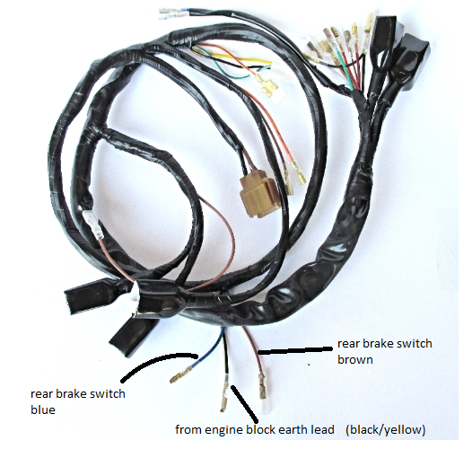

Hi Perry
My 77 kz1000 suffers the same problem if I do not have a good earth between the main harness and batt -ve / ground.
You need to ensure that the black with yellow stripe wire on your main harness is well connected to ground.
On my bike, the black/yellow wire on main harness is located closely to the brown & blue rear brake switch wires which can be found under the seat near the LHS side cover.
Verify that this black/yellow wire from harness is well connected to ground.
Best of luck.

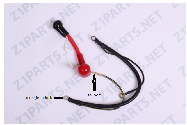

  • kz_1000a
  • kz_1000a's Avatar
  • Posts: 19
  • Thanks: 7
Re: Blinkers
24 May 2018 16:01
#783969
These pics might help
The following user(s) said Thank You: perrykz1000
