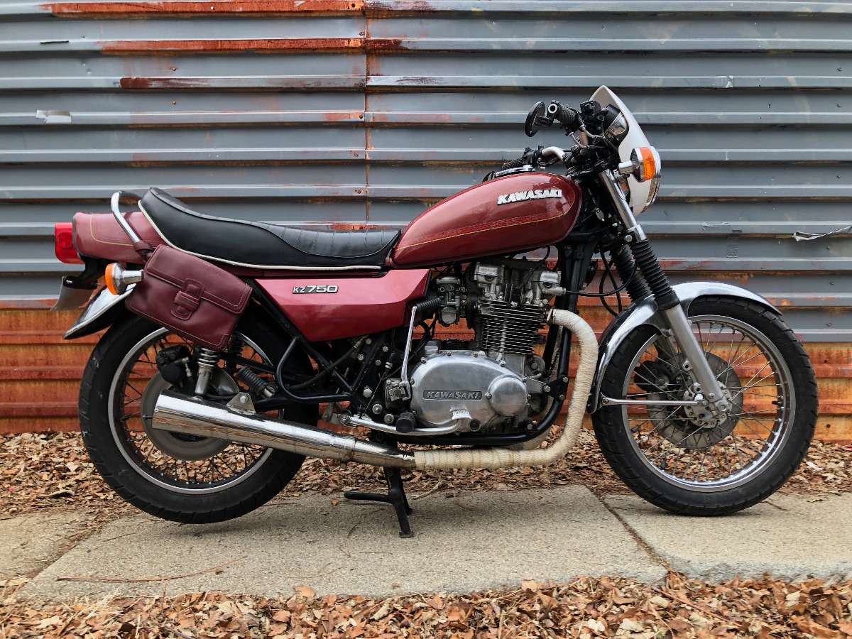

Thankfully, after all of this, the bike started right up. This is the bike as I worked on it today. The car in the background is my 1964 Buick.

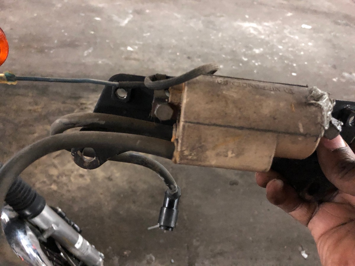

Thanks for responding. I think the issue was one or all three things I checked/replaced: Ignition coil (Photo below. The thing looked so old I was ready to carbon date it. I bet a few T-Rex's tossed it around), I put in a brand new lithium IRON PHOSPHATE battery ( to be honest, I think the old battery was shot) and traced out and moved wires in case the was a short/ground issue. Nothing like hearing a bike purr. I wish I could post video here:
