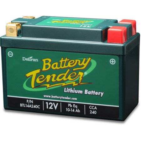

]I got this battery to replace stock. Has anyone run a lithium IRON PHOSPHATE battery in their bike without any probs?
Battery: www.walmart.com/ip/Deltran-Battery-Tende...833010&wl13=&veh=sem

as far as I know all lithium aftermarket auto batteries are LiFePO4. I've run them in my bikes for years. make sure your R/R is good and you'll be fine. Probably the cheapest and easiest way to loose 12 pounds off the bike. They crank really well too. Im pretty sure battery tender batteries are just rebranded and marked up so you might save a couple bucks for the same thing if you shop around.
