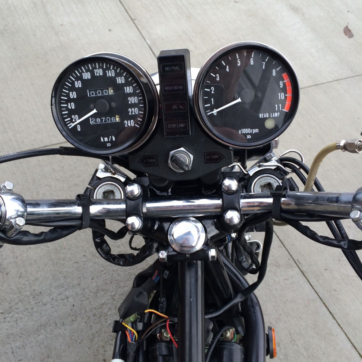

The new to me kz only has the high beam indicator working, I ordered a new instrument panel wiring harness due to the sockets falling apart when coming out of the instruments. Anyway can someone give me a rundown on these lights, I'm sure one is low oil pressure and one is neutral, what's the other one and also what does the headlight indicator in the gauge do, light with the headlight or light when it's out? The clutch switch has been removed will that affect the neutral light?

Hi Don, See the photo below for the light sequence. I believe the clutch switch first appeared in 1981. My wife has one on her 1981 KZ550. I don't have one on my 1980 KZ1000.

Stop lamp was the one I couldn't read, I assume the headlamp indicator light is on when the headlamp is also? I noticed a socket in the clutch lever mount where a switch might go I'm hoping the new harness and some ground work will get everything working again.
