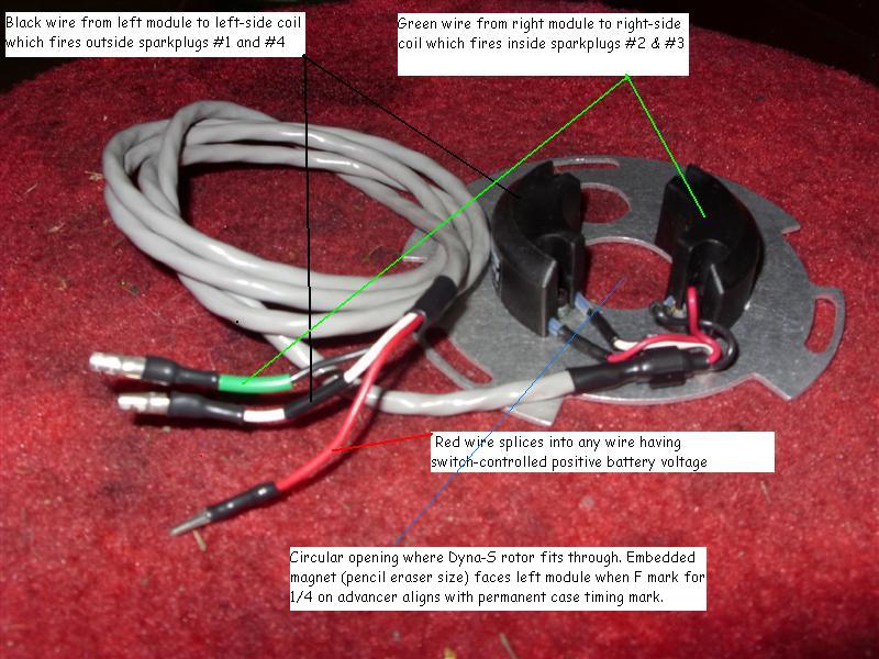

03 Nov 2017 06:15 - 03 Nov 2017 06:48The rotor is installed so that the embedded magnet passes the left side pickup module when the F1/4 mark aligns with the case mark.
Last edit: 03 Nov 2017 06:48 by Patton.
- Posts: 18640
- Thanks: 2100
Re: KZ750 Spectre help
03 Nov 2017 07:06 - 03 Nov 2017 07:10
Here's what's supposed to happen while the engine's running.
When the embedded rotor magnet passes by the left side pickup module, the ground connection from the ignition coil is interrupted, which loss of ground causes the ignition coil to fire both outside spark plugs.
When the embedded rotor magnet passes by the right side pickup module, the ground connection from the other ignition coil is interrupted, which loss of ground causes that ignition coil to fire both inside spark plugs.
It's comparable to a points system where opening of the points is what interrupts the ignition coil's ground connection.
