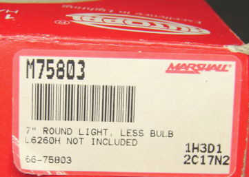

What is an asymmetrical head lamp? Is that a sealed beam or does it take an H4 bulb?
Re: New light
12 Jul 2017 11:39 - 12 Jul 2017 11:41
No eBay APP ID and/or Cert ID defined in Kunena configurationAccording to the eBay listing (below) it is not a sealed beam. It uses (but does not come with) a L6260H halogen bulb (assuming you can find one). Ed

12 Jul 2017 15:41 - 12 Jul 2017 15:43What is an asymmetrical head lamp? Is that a sealed beam or does it take an H4 bulb?
The head light on the left side has a different lens geometry to prevent blinding the drivers of oncoming traffic.

H4 conversation headlamp. All glass lense and metal back with high quality reflector. It's a inexpensive version of the Bosch of Cebie light. Got 2 of them for 35 bucks!no bulb.... I have plenty at my shop.
