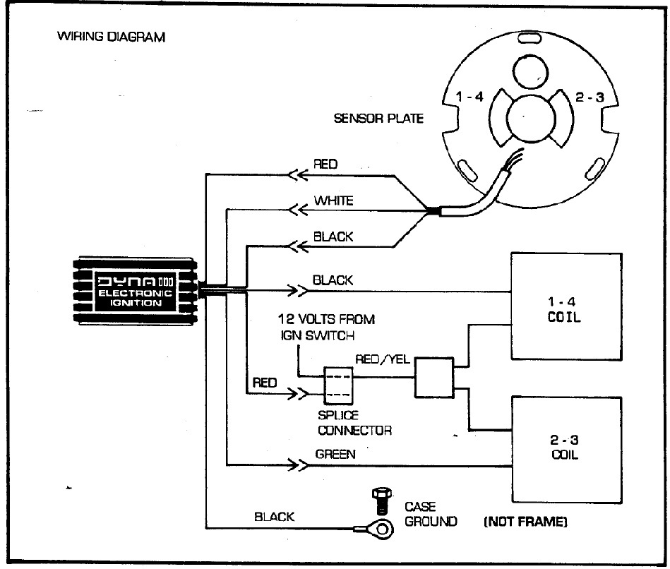

The Dyna III is basically the same as the Dyna S, but the pickup plate on the Dyna III only has the hall sensors. The Dyna S has the coil drivers built into the hall sensor assemblies, but the Dyna III has them inside the remote box.
I'll see if I have any more notes on the Dyna III, as that wiring diagram doesn't show the detail of what wire goes to which pickup.

On the pickup plate:
RED wire is positive voltage supply to the pickups.
WHITE wire is the signal from the front pickup (2-3).
BLACK wire is the signal from the rear pickup (1-4).
The pickup plate itself grounds to the motor case, so it is important to ground the Dyna III box to the engine case, which should also be a ground for the battery.
To test if the Dyna III box/pickups is bad:
Swap the white wire and black wire from the pickup plate at the connectors for the remote box..
Also, swap the black wire and green wire at the coils.
The bike should run fine this way.
If the problem moves to the 1-4 cylinders, then the Dyna III box/pickup is bad (or there is a wiring problem).
If the problem stays on 2-3, then it may be a bad coil (or there is a wiring problem).
A very common wiring problem is the use of the Dyna-supplied clamp-splice device. It's usually a blue plastic thing that connects to a wire by clamping on. Those are notoriously flakey.
Another possible wiring issue is the power to the coils may be flakey, so check the red/yel wire at the coils for voltage.
I recall some users reporting that the timing plate sometimes develops cracks, so check that out closely.
