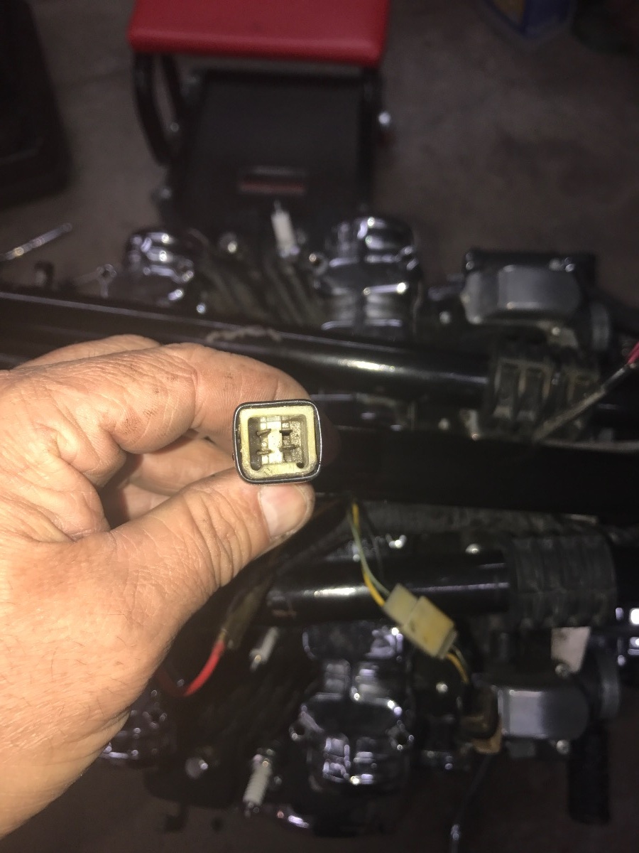

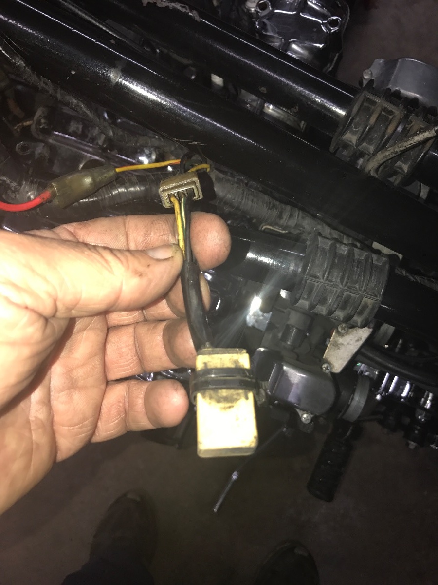

I received my coils and installed them with no problems. I found a plug that wasn't being used that I assume was from the old points setup and another plug with something like a relay plugged into the end. I took a couple of photos that I'll attempt to post to see if anyone can identify them for me. Also...I'm trying to find blue spark plug wire and found some that Taylor makes called solid core TCW that I assume is what I need, but their website says that solid core is not compatible with electronic ignitions. As I previously posted, I have the Dyna S and want to make sure that I get compatible wire. Anyone have any experience with this wire? The bike is blue, so I'm trying to spruce it up a bit. Thanks again!!

That relay is for the stop lamp warning light. The blue wires will work with the Dyna S. Pic of the wires on that 4 pin connector?
