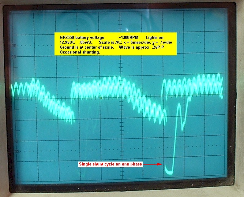

This link shows the shunting characteristics of the Kz (using the shunt type regulator). It also shows the voltage waveform of the bike's system voltage.
gpzweb.s3-website-us-east-1.amazonaws.co...rnatorWaveforms.html
From that link here is a screenshot of shunting happening at 12.9v (average). The average was only about 13v on the meter.
The screenshot shows several traces superimposed. Only one had the shunt event, as they are relatively rare at 12.9v, but do still happen. Actually, if you look very closely at the image, you will see a very faded trace of another shunt just to the left of center of the screenshot. So it is not an aberration to shunt at 12.9v. It is regular, even though it is neither frequent, nor predictable.
All else being the same, just a change in RPM can cause the regulator to shunt more or less frequently. The last two images on that link show the higher (3000 RPM) case is shunting more, even though the average DC voltage, as measured on the meter, is actually lower than that of the 2000 RPM case.
