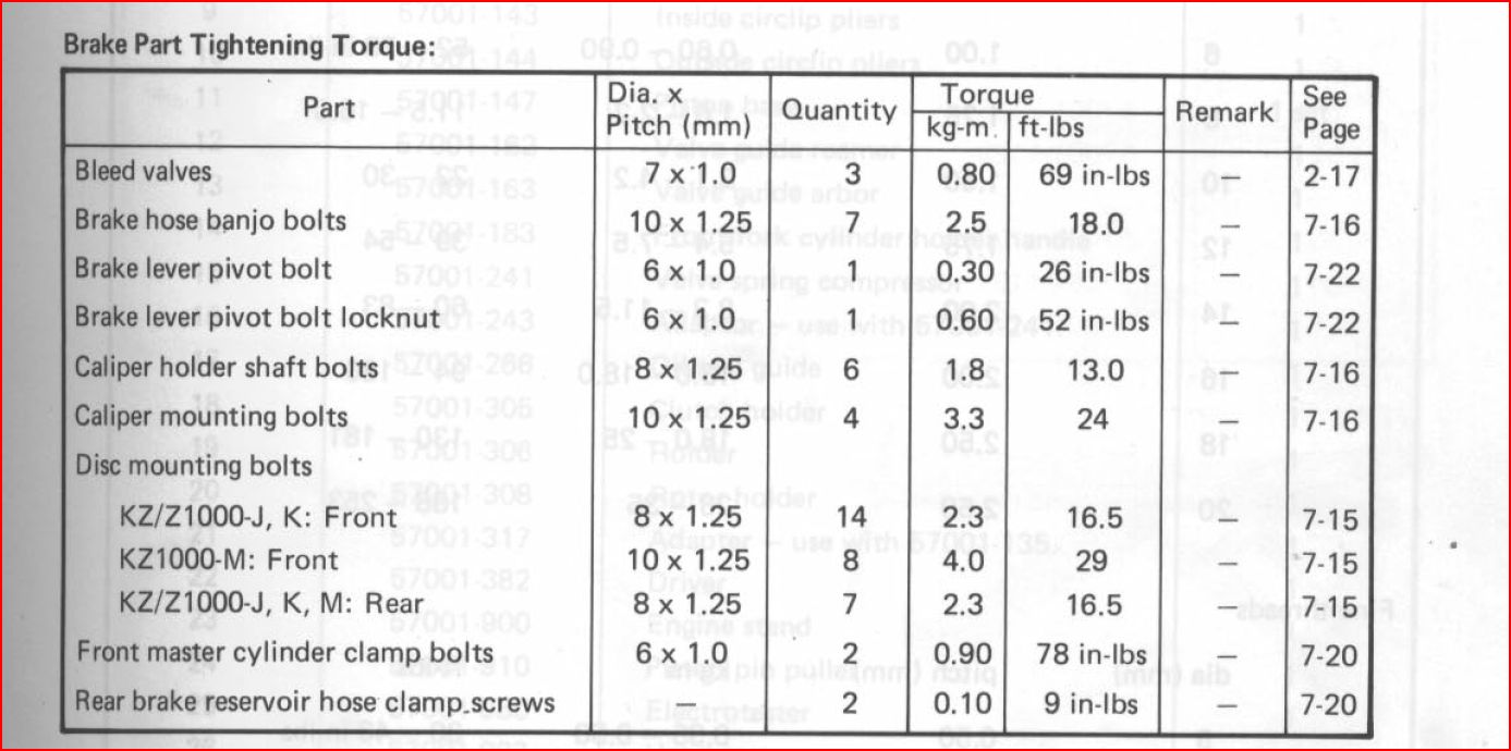

I am thinking of fitting one of those banjo bolts that have the brake light switch incorporated into it, but I am not sure of the correct thread for my bike. They seem to come in two sizes M10 x 1.25mm and M10 x 1.00mm.
Does anyone know which is the correct one, my bike is a 1981 KZ1000 J1.

Instead of wasting time on the interweb, i should have just gone to the trusted source, the fsm.
From page 1-11
From page 1-11
