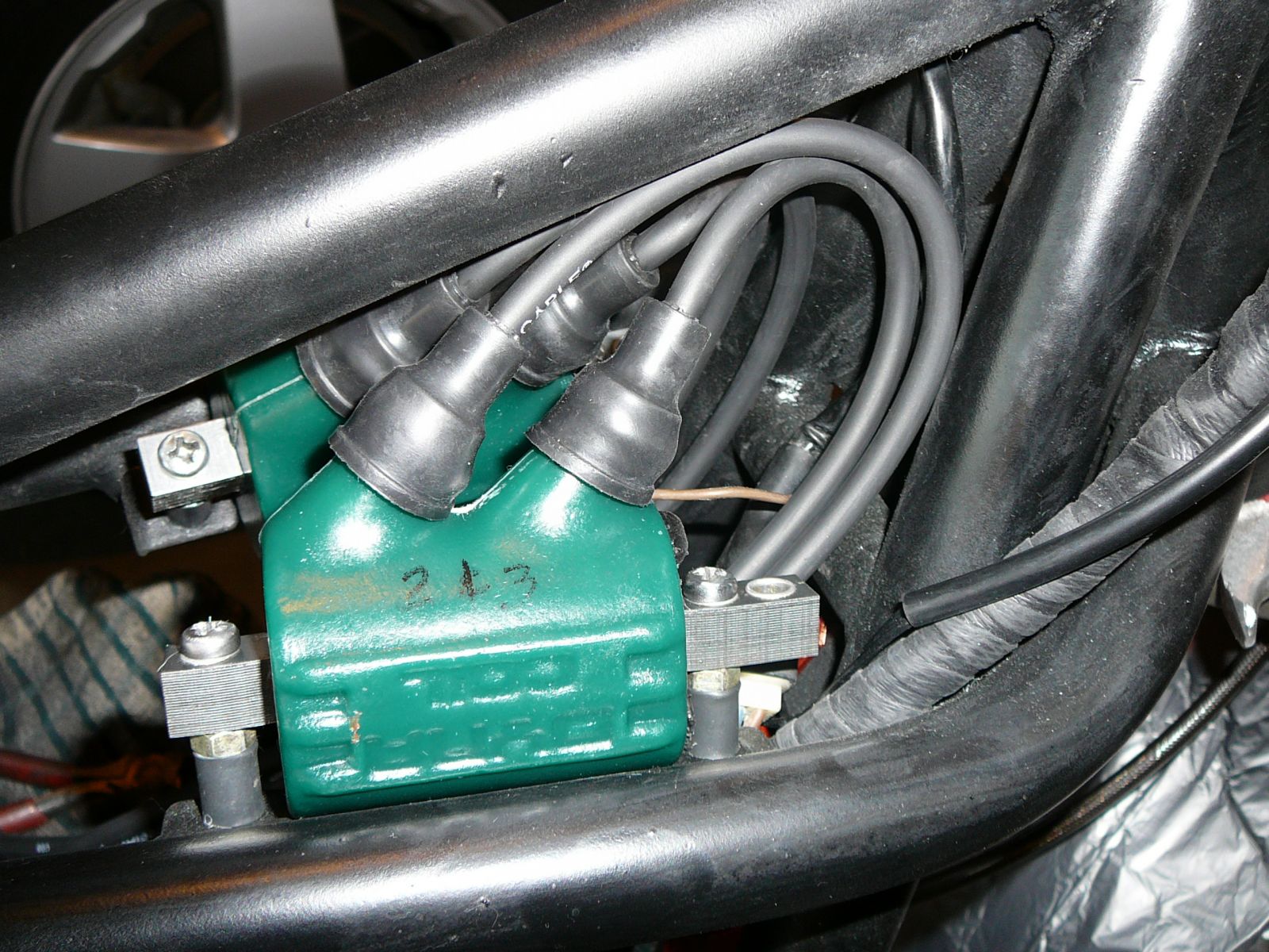

The Dyna ignition coils may be mounted with the spark plug wires exiting forward or exiting toward the rear (at least on the large fours).
In this example, the spark plug wires exit forward, which is how stock ignition coils are routed from the factory (at least on the large fours).
