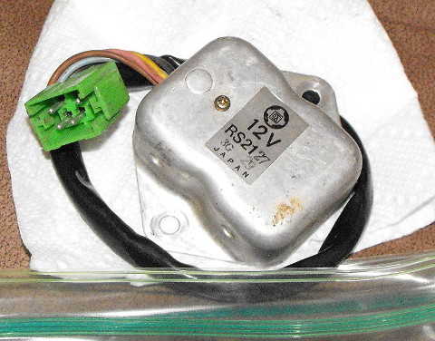

Definitely different than the stock 1977 KZ650 regulator. Mine is like the one shown below. Ed

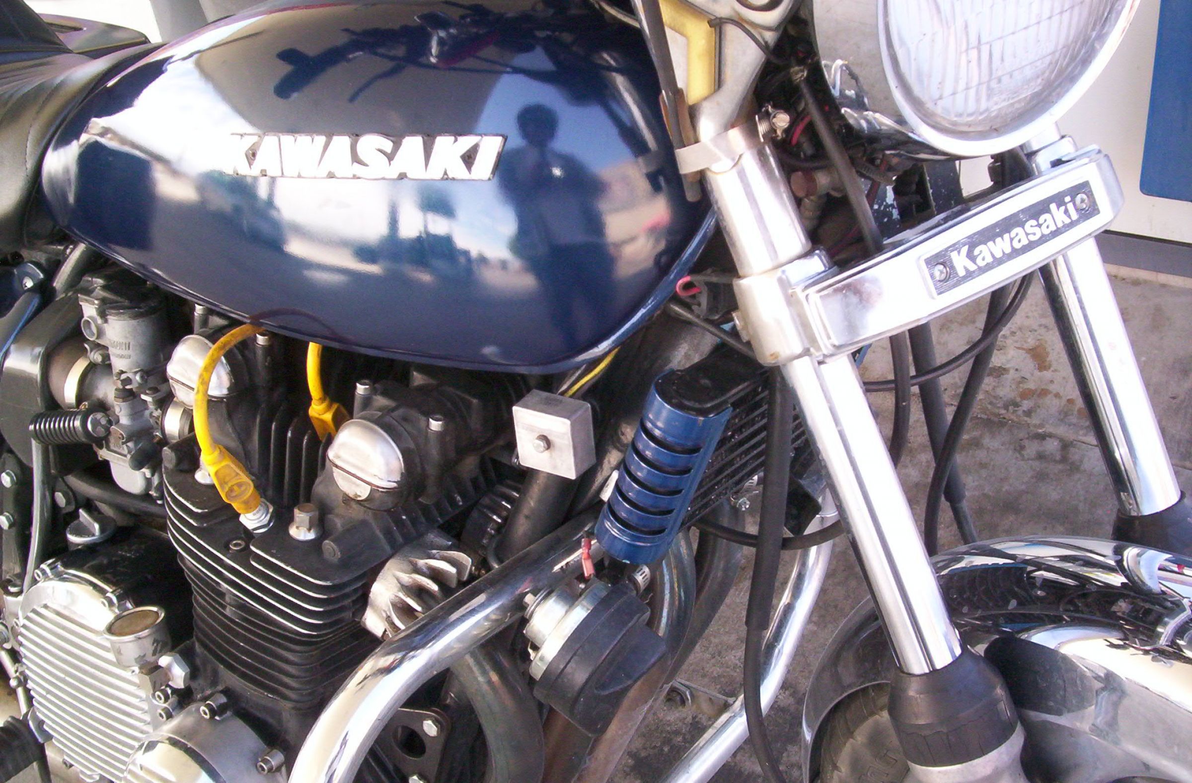

Before I went to a modern regulator and rectifier I had to use two aftermarket regulators in my system to keep from boiling the battery and blowing out lights. I still have one attached but not hooked up. The stock rectifier burned up so I installed one from a 650 Yamaha 30 years ago. It is larger and worked well. The stock regulators were known to be junk and prone to fail.
This worked for a long time until I got the bike back up in 13. Got a used KZ 1000 R/R from the oldkawman and he sent me instructions how to hook it up. Very easy to do and I still have them if needed. The ones Ness is talking about hooks up the same way. I'll be buying one NEW soon. For the time being what I have works well enough.
