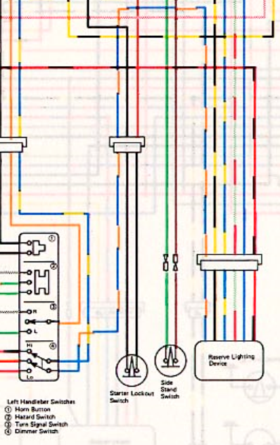

I'd like to bypass my lockout too. Its a PIA and I'm going to be replacing my switch gear shortly. Mine has 3 wires, It looks like the 3rd goes to the reserve lighting box. Do I need to jump this wire somehow?

Actually, by looking closely at the diagram I think I have it figured but verification might be helpful. I tie the 2 wires to the lockout together than just wire my new high-beam switch into the blue/yellow line on the 3 pin connector. Sound about right?
I tried just tying the 2 wires together, at least I think that's what I did, but apparently the starter wont turn unless all wires are connected to the reserve light box.
