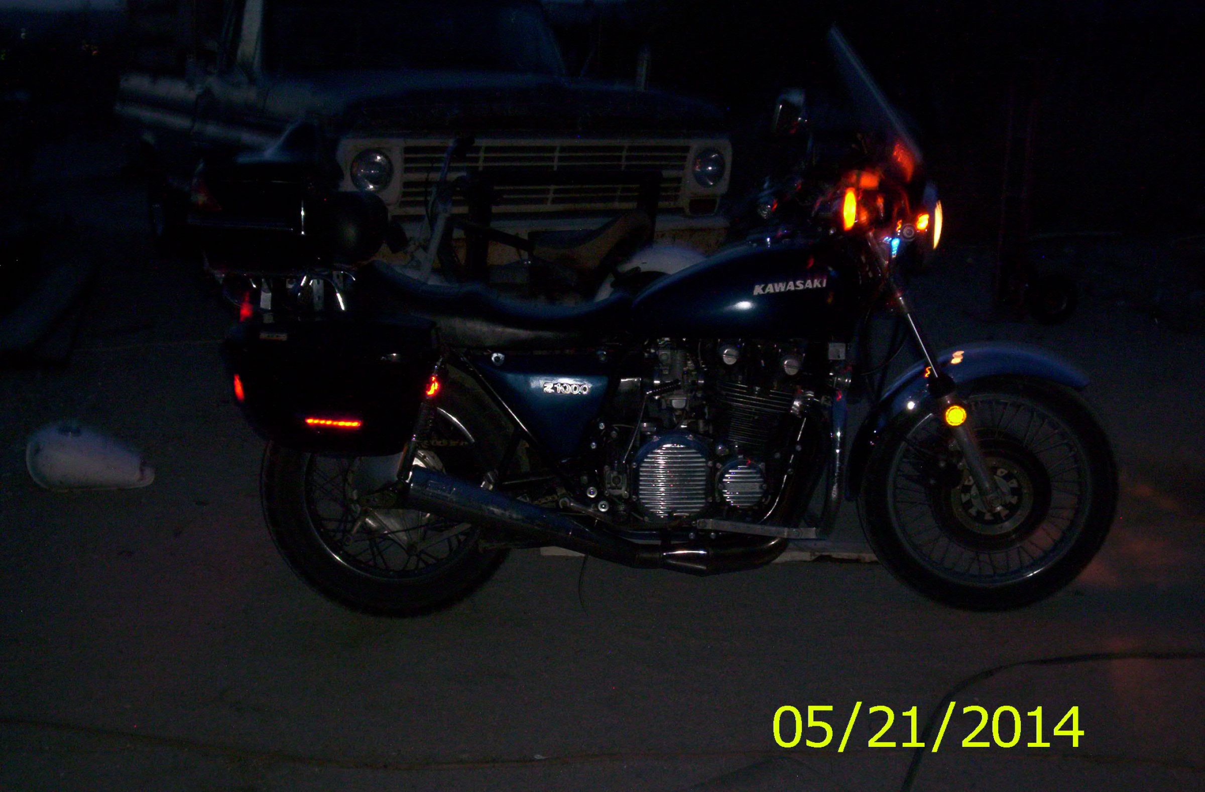

I have duel element turn signals I put LED's in and Led lights all around.

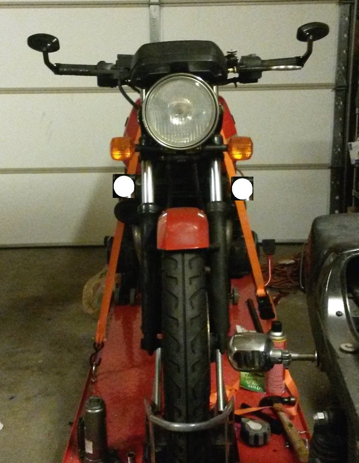

I went out to the garage, put ratchet straps on the handle bars and pulled the forks down to the stops. I then played around with the lights I have. They came in some funky cage style mounting apparatus and if I take one half of it off and use some U-bolts they will probably mount well where i put the white dots under the headlight. They should be perfectly safe even at full fork compression. This is where I was originally thinking of putting them but I wasn't sure they'd fit.
The other choice is mounting them where the side reflectors are, just above the horns behind the oil cooler but I'd rather they be on the forks.
Any other ideas or examples to consider?

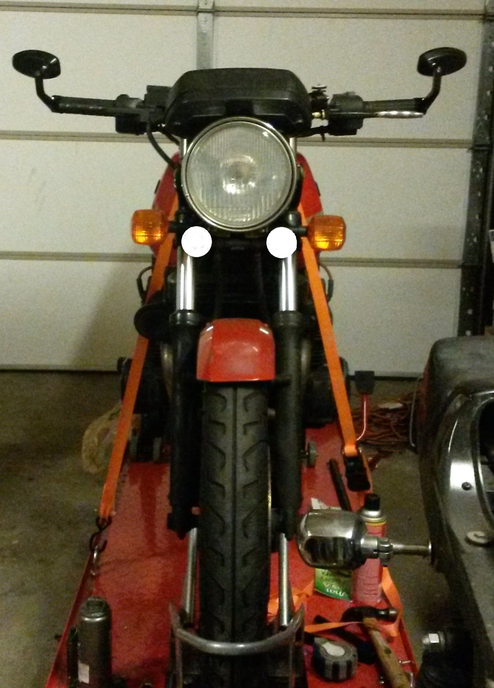

09 Apr 2016 19:45rstnick wrote: If you can mount them further away from the headlight oncoming traffic will see you better.
I read a study where they said people had a hard time judging the speed of an oncoming motorcycle with a single headlight.
Having two additional driving lights spaced further out made the oncoming motorcycle more visible, and a lot easier to judge it's speed and distance...
Interesting, makes sense.
This is the most "streetfighter-ish" location I can think of. The aesthetics of anywhere else sucks.The only way to put them further apart is to move them outboard of the fork tubes and relocate the blinkers to another location but I don't know where. The best alternative is where the reflectors are but they would be behind the forks and might obstruct part of the light diminishing benefit to me in darkness.
