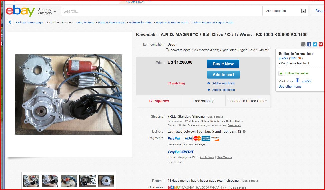

I am no electrical expert like Lou and some of the other members here, but I am pretty sure the only way to get a single-coil ignition system to work on a 4 cylinder kz engine is to invent or adapt some device that performs the role of a distributor. I remember seeing a device like that that replaced the ignition cover. I suspect one would be really hard to find these days.

These folks may be able to chase down a magneto system if one was ever built for the J engine...
www.classiccyclecity.com/gallery/index.php?cat=4&page=1

You can use a magneto system on a KZ, but they have to be a specially made contraption, that is single-coil with distributor, or dual magnetos and dual coils. Magnetos are not great at producing a long duration spark, so they might not run too well at idle or mid range on a motor with suspect jetting, but they usually have good voltage so they might help out a high compression race motor. They are not usually worth the hassle for a daily driver (you can see how much hardware they require), and are mostly used for coolness points at bike night. MSD has replaced the use of magnetos for firing a high-compression (or turbo/supercharged) motor. (MSD and magnetos both work by feeding a short-duration, high-voltage spike to the coil.)
But most KZ's have a permanent magnet alternator which delivers a lot more energy than a magneto, so the simplest thing is to just replace the battery with a capacitor. This requires keeping the reg/rec and requires a few minor wiring mods, but is pretty easy to do.
The big question is starting the thing. Also, the bike needs to be in good tune. If it's hard to start with a battery, it will be harder without.
