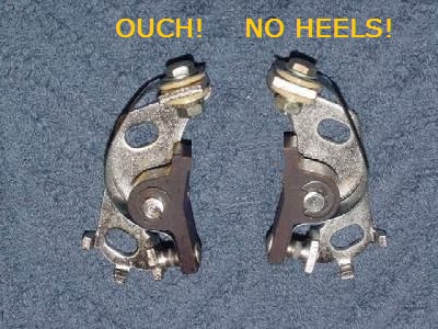

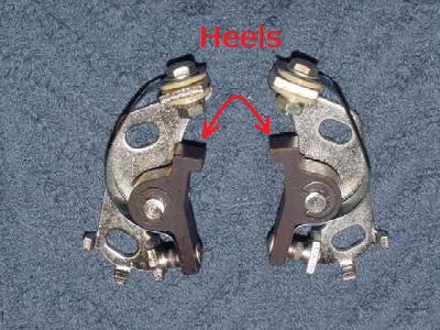

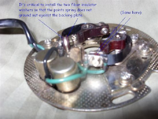

bluej58 wrote: . . . I got 2 and 3 to drop off just past the "F" mark like it should but on the 1 and 4 point the needle stays spiked even with it opened
When I disconnect the green and black wires from the point to the coils I can get 1 and 4 to drop off. . . .
Perhaps the heels of the left-hand-side points (black wire from 1/4 coil) are worn off whereby the points are failing to open.
Or perhaps the fiber insulator washers are defective or missing or improperly installed, whereby the black wire from 1/4 coil is always staying grounded even when the points are open.

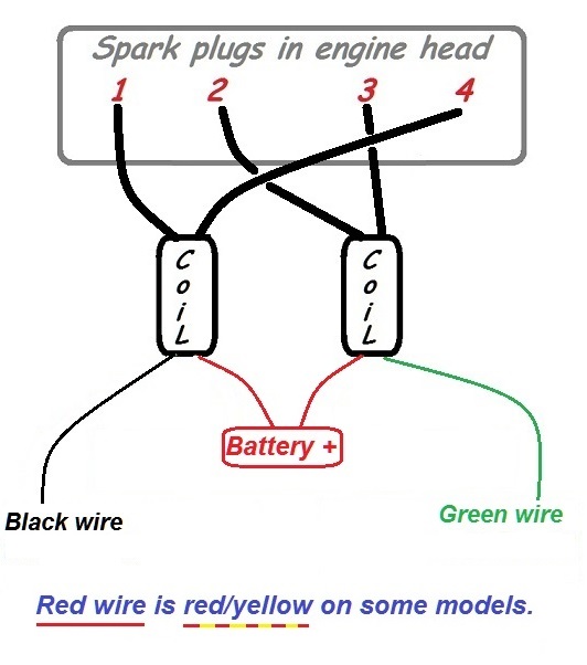

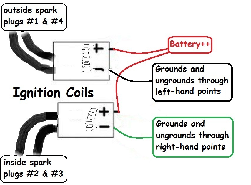

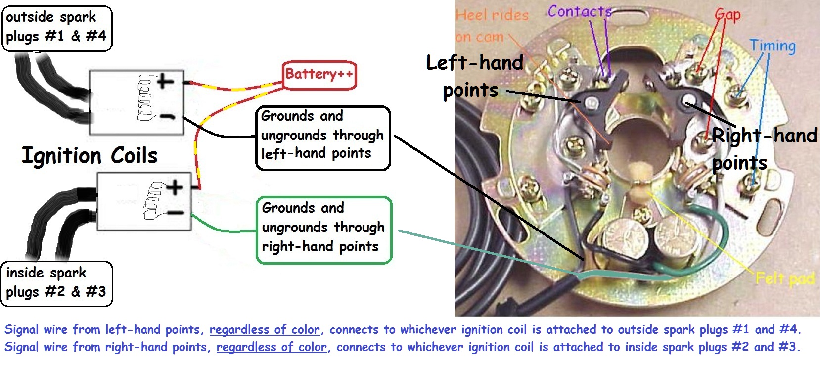

Here's how the black wire is supposed to cause the 1/4 ignition coil to fire:
While the left-hand-side points are closed, the black wire grounds the 1/4 ignition coil through the closed points.
When the left-hand-side points open (the contacts separate), the black wire becomes un-grounded, which is the event that causes the coil to fire.
Same for the green wire from the 2/3 coil to the right-hand-side points.

bluej58 wrote: . . . I think that the 1 and 4 point was always open when I tried the first time . . . .
The points must be closed in order for the coil's primary winding to be grounded (via the black wire from the coil through the closed points to ground), which allows the coil to "charge."
Then, when the points open, the "charged" coil fires (i.e., discharges) through the secondary loop.
If the points always stay open, the coil never charges, because the coil's primary winding isn't being grounded through open points.
With a piece of paper between the contacts, the points act as if they are always open.
