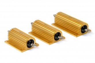

As mentioned in earlier threads about this.... I am running two 3 ohm Dyna coils with points, temporarily right now, but, I also fabricated a ballast resistor from two, 4 ohm 50 watt Arcol resistors, wired in parallel for a measured 1.9 ohms.
