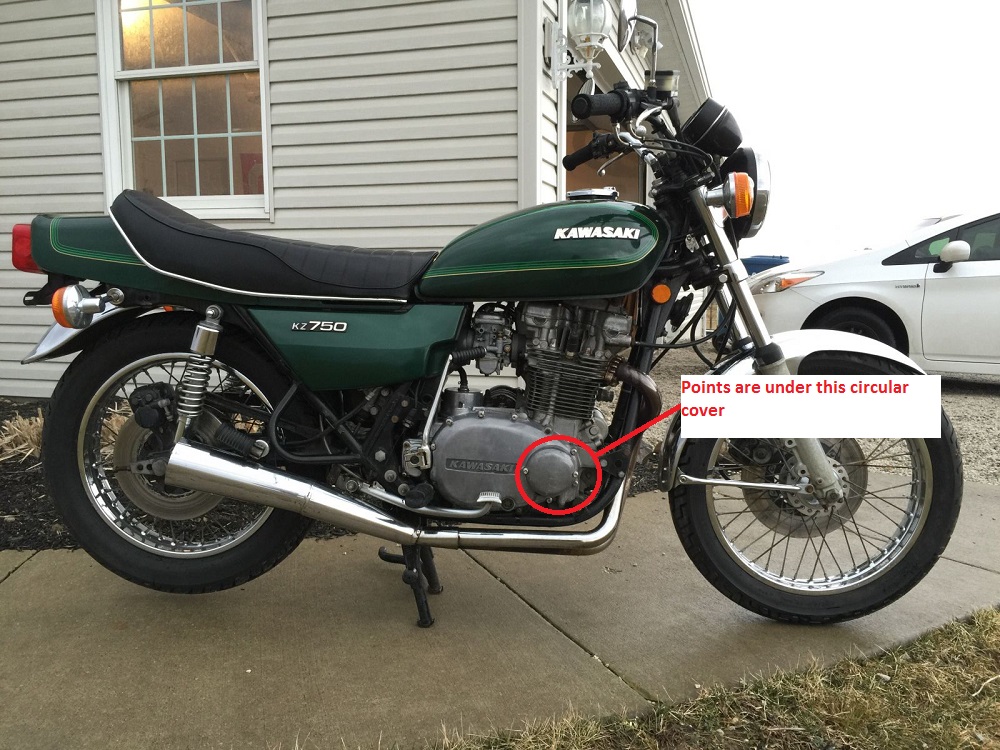

My 78 KZ750 twin won't run now after I washed it. It ran great when I bought it. I washed it and now it don't have a spark. I checked my plug when I turned it over. No spark? Coil? Thanks

Water on the electrics and on the coils and wires under the gas tank. Water around the plug caps like Ron said.
Take off the gas tank and spray with WD40. Thats what its meant for. Water Dispersal
Also possible water on the points and stuff under the points cover if the gasket is bad and particularly if you used a hose . Check under the points cover

Points are wet. Weak connections to the switch, coils etc. when wet won't work.

Take your tank off and check to see if your getting power to your coils.

How do you check if the coil is bad? Also where is the points located. Thanks all for your help

Re: Washed my KZ. Now won't start??
05 Apr 2015 18:29 - 05 Apr 2015 18:33
I'm pretty sure your points are under the circular cover. Also possibly a condenser
I know little about the 750 twin so hopefully others more knowledgeable will be around soon. I dont know if you have 1 set of points or 2. Also dont know if you have one coil or 2.
To check if a coil(s) is getting power you will need a multimeter.
Remove the gas tank.
The coil or coils will have 2 wires one of which will probably be red
Turn the ignition key to ON. Dont start.
Set the multimeter at the DC 20 volts range
Touch the positive probe of the multimeter to the red wire at the coil and the negative probe to the frame of the bike and you should see 12 vots. Should be the same or almost the same as connecting to the pos and neg terminals of the battery.
