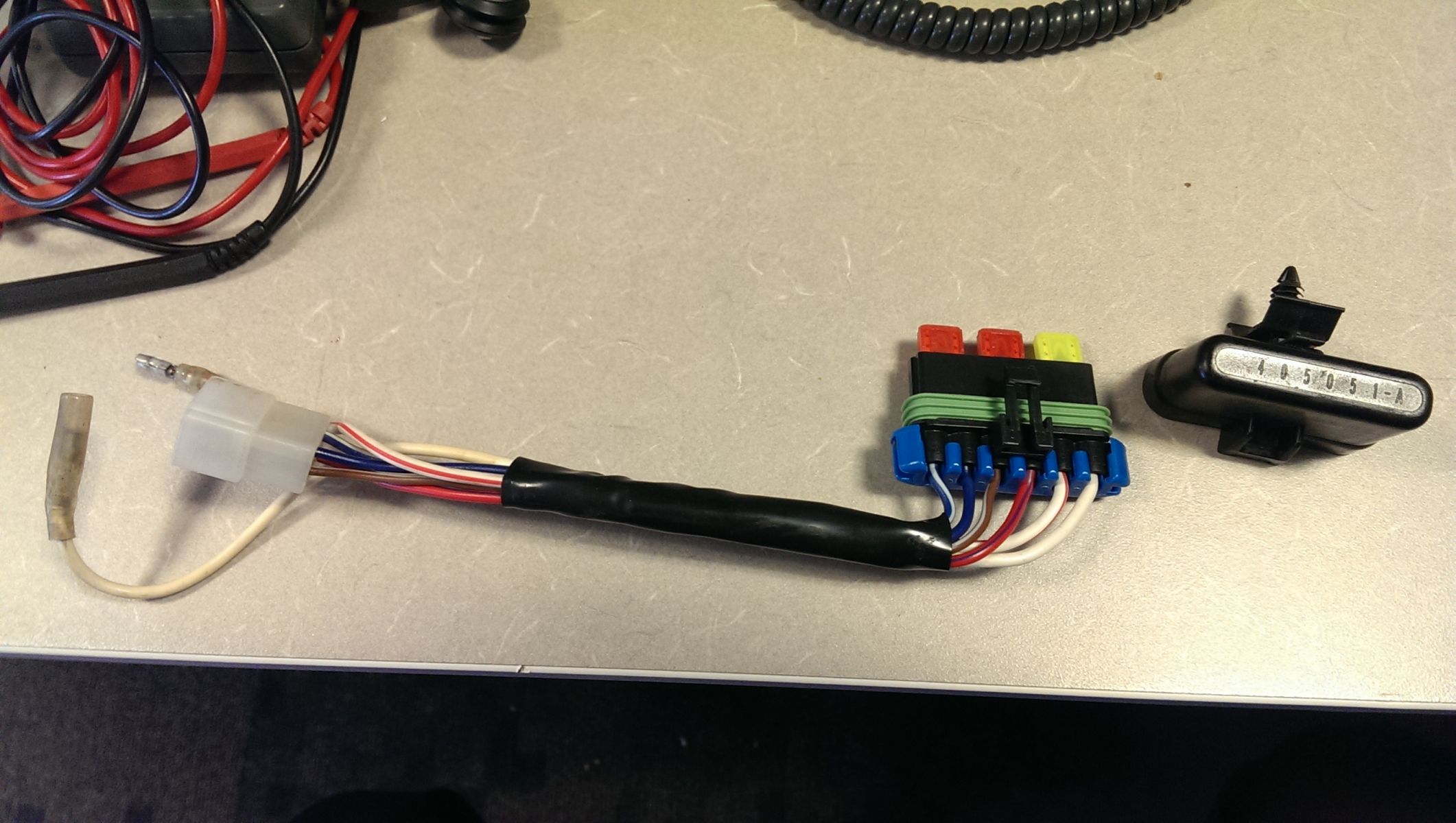

I just replaced the stock failing fuse box on my 82 KZ750H with a metripack unit from cycle terminal. Way less voltage drop with the new setup compared to the old, it uses easily avialable ATM fuses and it is reasonably well weatherproofed so I don't expect it to ever have a corrosion problem. The only hard part about it was finding a crimper around my office that did a decent job on the pins. It is literally a 10 minute job and it only cost $21 including shipping to Canada. This kept all the fuses in one place and with a little bend of the stock fuse box bracket the new fuse box is held reasonably securely in the original location. My original fuse box was dropping nearly 0.8V and the connectors were getting hot enough to melt the plastic even after cleaning and re-bending them.
Just don't do what I did - get the 4 position box instead of the 3, on my bike there was a second smaller fuse box tucked away behind the 3 position one that I didn't see until after my order had shipped.

Edit----And forgive me for not knowing but what awg will I need to order as there are two different sizes listed for the wiring which is why I didn't order last night.
I was just looking at these last night but didn't know what gauge wires to run and here I see you reused the stock wires. Cool, so I am going to order up one right now. I wanted the four fuse holder but didn't see that option. You know the gps and cell phone charger is a very necessary part of riding long distances I would say.
zero10 wrote: I just replaced the stock failing fuse box on my 82 KZ750H with a metripack unit from cycle terminal. Way less voltage drop with the new setup compared to the old, it uses easily avialable ATM fuses and it is reasonably well weatherproofed so I don't expect it to ever have a corrosion problem. The only hard part about it was finding a crimper around my office that did a decent job on the pins. It is literally a 10 minute job and it only cost $21 including shipping to Canada. This kept all the fuses in one place and with a little bend of the stock fuse box bracket the new fuse box is held reasonably securely in the original location. My original fuse box was dropping nearly 0.8V and the connectors were getting hot enough to melt the plastic even after cleaning and re-bending them.
