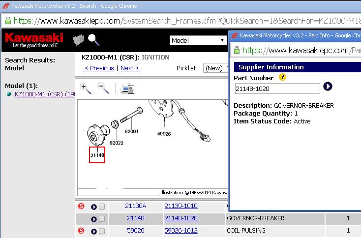

That's what I've been told by a kawasakitmotorcycles.org member that's dealt with police kz's for 30+ years. I need to find a stock rotor, since miine went to that void where all missing things like to go hang out at. Where's a good place to get one? I still have the stock condenser plate and I'm gonna build a gm hei ignitor. I built one for my gs650g last night and that thing works like a charm, the replacement ignitor, not so much. And I think I still have the stock connectors and harness. I'll see here once I get the gs650g back together and start digging around for my kz's stuff

That part is part of the advancer, and as a last resort, Kawasaki still has them listed as "active" so you can theoretically get a new one with a new advancer and new springs.
I'm sure it will be very reasonably priced... if you get what I'm saying. :lol:
