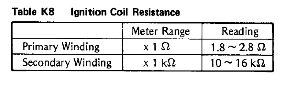

Per FSM for 1983 kz750, resistance of ignition coil primary winding is 1.8 ~ 2.8Ω.
What are the test results for the coil to 1 and 4?
If needed, may download the FSM with this link:
kz.bike-night.com/media/GPz750-full.pdf
