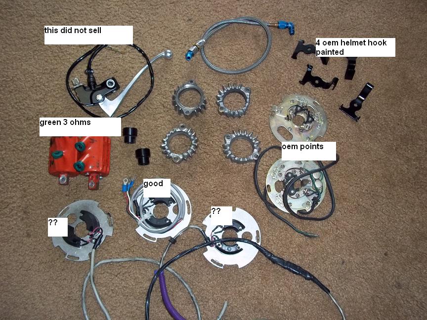

31 Jan 2014 05:41Speaking of Dyna S, before I call them or wait for an email reply.kaw-a-holic wrote: Have you went to their Website and downloaded the trouble shooting yet? Complete that first then call Dyna. The hold time is long but they have a great bunch of guys.
www.dynaonline.com/skins/downloads/
I have heard of guys sending them the units to test and diagnos.
Anyone know what they charge?? I have 3 Dyna S units that have been sitting for many years.
This was an old pic. when I was selling bikes last year.
Priority back & forth only $11, I can send them a prepaid return mailing package.
