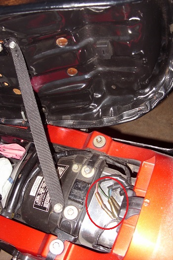

Hello Everyone,
This is my first post here. I have been reading these forums since I picked up my 95KZ1000P a few months ago. I must admit, it is very much a wealth of knowledge. I seem to be having an issue with my running lights. A little background on my set up.
When I picked up the bike, pretty much all of the electrical (headlight, front and rear turn signals) were removed. It didn't look like there was any chopping to the wiring harness that I could tell at first glance. Ditching the police set up, I opted to go with more subtle indicators. I put a 7 inch round headlight in the front with Emgo Mk 2 smoked indicators and the rear has an all in one LED brake light and turn signals. I know, that it may not be strictly legal but I will cross that bridge when I get to it. I know that LED and old thermal flashers don't play well together and I picked up an electronic flashing unit. My front and rear turn signals, and brake lights and head light work fine. The bike will turn over as well. The issue is I don't have hazzards, and I don't have a running light. My light does come on when the key is placed in "park" but naturally at that point, I don't have turn signals or anything else as I am sure it was originally intended.
I have already looked through the wiring diagram, I have pulled all the electrical connectors and bullet connectors apart and cleaned them with electrical cleaner (that is how I got my brake lights to work when using the front and rear brake pedals). I replaced the fuses with new ones. And I know that the light does work (as indicated putting the key in park). I am just not sure where else to go. Do I just run a parallel wire from the red wire coming from the ignition and run it to the running wire on the brake light? I did test the brake light with the original OEM brake light and I am still getting the same issue so I think its safe to say its not the aftermarket tail light. Short of chasing down broken or shorted wires, whats next? I very much appreciate your help.

Hello, nlwatkin, and WELCOME to KZr!
If not already done, would assure there's voltage at the bullet connector from the harness that feeds wire to the rear bulb's tail light filament.
The bullet connector is probably under the seat, over the rear fender.

Hello there!
I appreciate the response. I definitely pulled all those connectors apart and cleaned them. I had to go out and get a new meter. I will start the not fun task of chasing wires down. I appreciate the response again and when I find something, Ill be sure to post it here.

01 Sep 2013 22:40
I went through with a meter after I tried cleaning the contacts again with electrical cleaner. Granted it was not the deoxit that you suggested but was an electrical contact cleaner I got at Ace hardware. I went straight from the solder point for the red wire on the ignition. If in park, I read 12 volts, if I am in regular "on"...I read nothing. A nice flat 0. Does this mean I have a bad ignition? I already pulled the ignition apart and cleaned the copper contacts. Still reads nothing if the key is in the "on" position. Thoughts? Anyone else have problems with this?

It might be time for a new ignition switch, especially if this is what came with the bike. They do wear out, from vibration, and the off-on cycles.
BRAKE/TAIL LIGHT Can be an # 1157 dual filament bulb
RED, Running or Tail Light.
BLUE,(sometimes with a Red stripe) Brake Light Circuit.
BLACK with YELLOW stripe, the ground circuit.
