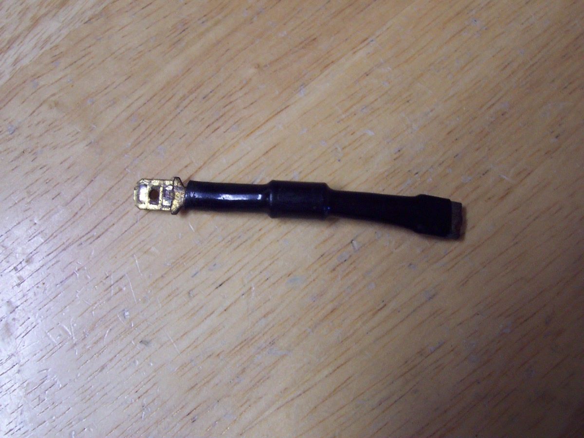

Two bikes. 77 kz1000 and 76 kz900. Both bikes have this connector to the flasher. Both bikes turn indicators will not work with this installed. Remove it and everything works???

That's a Diode, a one way street for electrical current. So power will flow in only one direction.
en.wikipedia.org/wiki/Diode Down the page you will see the symbol used in an electrical wiring diagram, an arrow really. Look at your wiring diagram in the service manual, or here in "File Base", for the proper location of fitment.
