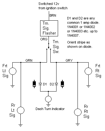

Hi,
I have recently bought another speedo/gauge for my '81 kz650, a more minimalist speedo with only 4 small warning bulbs.
Each warning bulb (oil, neutral, beam and flashers) have their own + and - wire.
But here comes the problem; the bike is born with dual turn signal indicators (left/right) and the new gauge have only one indicator light. If I connect the left and right turn signal wires directly to the gauge, the whole thing will bypass and all 4 flashers will go off at once.
Take 2; I've fitted a wire from flasher relay to the new gauge, and it works like a charm. Turn the switch left or right, the correct flashers work on each side and the gauge-indicator flashes...
... but turn the signals off, and the gauge-indicator keeps glowing, with a constant light, instead of turning off?! Grrr... :S

Find a forum member named "Loudhvx", and ask his advice. I think having a small blocking Diode will let you use one turn signal indicator with out having to do confusing wiring. The Diode acts like a one way valve, preventing current flowing to places not needed.
