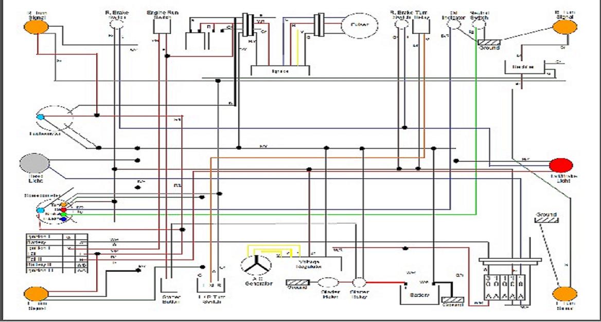

Ok, I have torn out the wiring harness this winter on my 92 KZ1000p. My hopes are to clean up the wiring mess with something neater. Couple things to note before checking out my wiring diagram I drew up.
1. I am wanting to lose the Engine Run Switch - so that is why you won't find it. Just going to operate off the ignition key for power.
2. I am cleaning up the handlebards so the Starter Button is being moved to the left side with only the Turn Signal Switch.
3. On the right side will be the Headlight Switch.
Let me know if this will work or am I wasting my time on trying to eliminate the Engine Run Switch?

If you need it, here's the wiring diagram from Kawasaki for the police bike:
www.cyclepsycho.com/kz1000p/kz1000p.html
My feeling is to leave the run/stop switch in the circuit, as it's a safety, in case you need to kill the engine like right now.

I'd keep it too; you never know when you might need it. Maybe it could be changed to something like the button switch in the pic below if the stock switch looks too big...

So you think I'd be better off to wire the Headlight to come on with the Ignition or Engine Run Switch. I am losing one or the other Unless I hide a toggle somewhere on the bike for the headlight.

Here is my wiring diagram without the Engine Run Switch. MFolks I used the diagram you sent me last year to come up with this, losing all the police wiring that I didn't need.

Try to make sure all of the splices, are the kind that's covered in heatshrink tubing, they resist moisture far better than tape does. Anytime on the wiring diagram, a wire crosses another, and a dot is shown, that's a splice area.

Thanks for the help. I actually drew my diagram again and this time have the headlight coming on when I turn the iginition key. I also have wired in the Engine Stop button on the diagram. No time to see if it all works.

Here is a better version of my diagram I came up with. I have the headlight hard wired to always be on. I have taken all of the police wiring out of it. So I think I have it figured out now. Started running wire today and will work more tomorrow on it with hopefully a test start and check to see if my battery is charging.

I do have one question. I ran the white wire from the battery to the Ignition. Tested the wires coming out of the iginition for juice. The Brown and Yellow were hot at like 13.4 volts. The Blue and Red wires did not have any power. Is this a bad ignition switch? I thought those 2 wires were hot all the time.

Your diagram is not very readable as posted. Hard to make out the Lettering for each component. Also the size is small, I've opened it in a photo viewer to try and see it better. Also Paint to re-size it. Maybe go back and clean it up a bit, so the Text comes out better.
