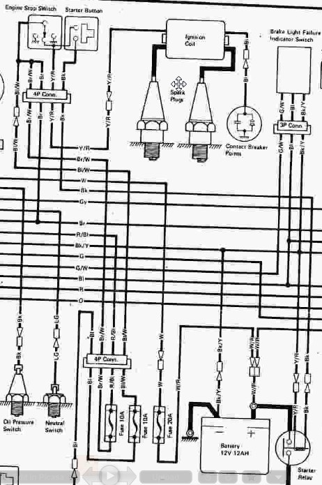

Post up the Brand and Model of the Meter your Dad has, and we can look it up to see what it has. Possibly tell you how to use it etc.
Otherwise if you want a basically free test light, you can use a piece of wire and the Tail light circuit, or a Turn Signal. Under the seat you will see where the tail/ brake plugs into 3 bullet connectors, the Blue wire will work, just unplug it, then connect to the rear/ tail light end. Then this wire can be used to touch to voltage points at the battery, then fuse panel, and eventually the starter solenoid circuit from the Start Button etc. Cheap and effective, it won't tell you voltage, but will tell you if power is supplied in the circuit.
Somewhere on this Twin Forum there should be a wiring diagram for your bike,
www.armbell.com/kz400/index.php?mforum=kz400
Or the one here on kZR in "File Base" it will be very similar,
www.kzrider.com/filebase/doc_download/104-kz400h1wiring-diagram
Here is a section of the wiring for the Start Circuit.
