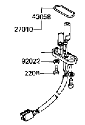

Re: ---->>>> Low fuel switch photo photosz
24 Oct 2012 13:15 - 20 Feb 2013 12:00The yellow wire (blue arrows) is insulated from the base plate.wireman wrote: Can you post a picture of the leak?
The connection is press fit or something. Over time, it becomes loose & leaks.
I'm assuming he has the same fuel level switch.
Low fuel switch photo photosz zphotoz

right out of the red thing.... i installed some jb weld and it seems to be working fine. i tried looking for a new one on ebay and i couldn't figure out what to call it.

26 Oct 2012 11:28The parts diagrams at kawasaki.com usually show both the name and part number.donthaveakawman wrote: ...tried looking for a new one on ebay and i couldn't figure out what to call it.
If needed, there's a link in my sig for help with navigating.
An ebay search using only the part number often produces results.

A nos fuel level switch would be good, but they're usually priced kinda high nowadays.
Used will be listed in several ways: fuel sender, fuel sensor, gas sensor, gas gauge, fuel gage, low fuel switch, etc.

No eBay APP ID and/or Cert ID defined in Kunena configurationPer kawasaki.com, the same FUEL LEVEL SWITCH, part number 27010-1055, is shared on the following 14 models:
