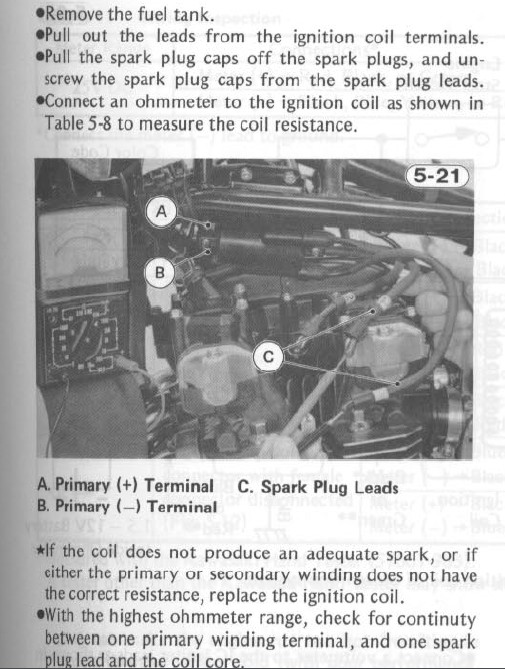

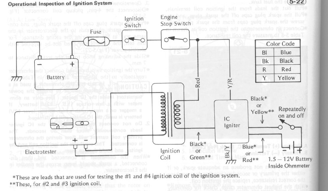

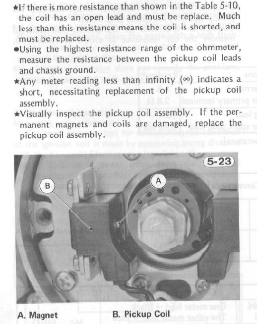

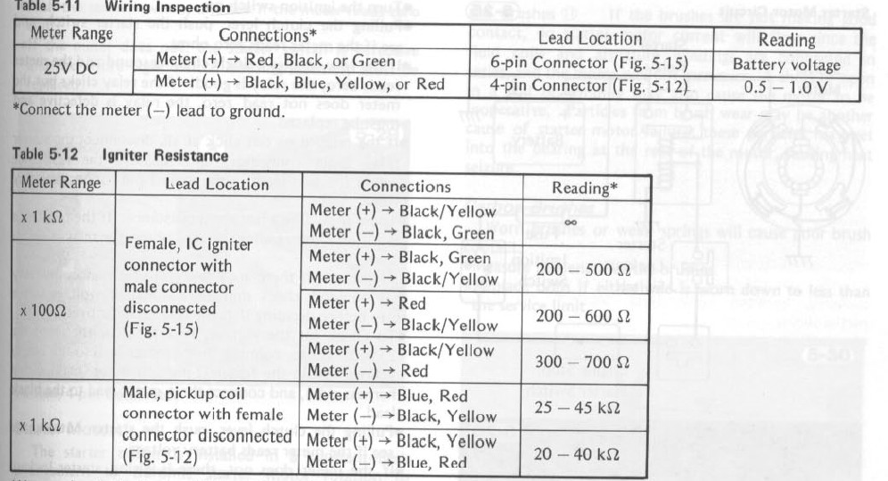

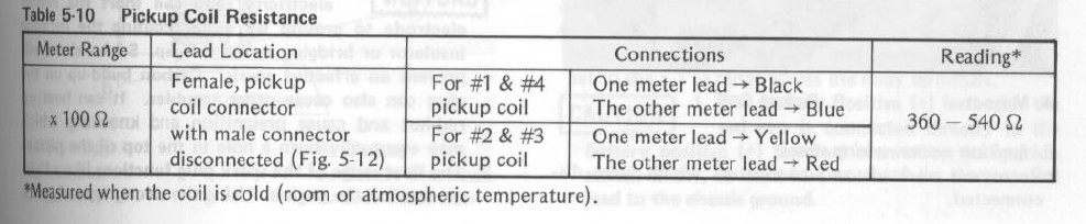

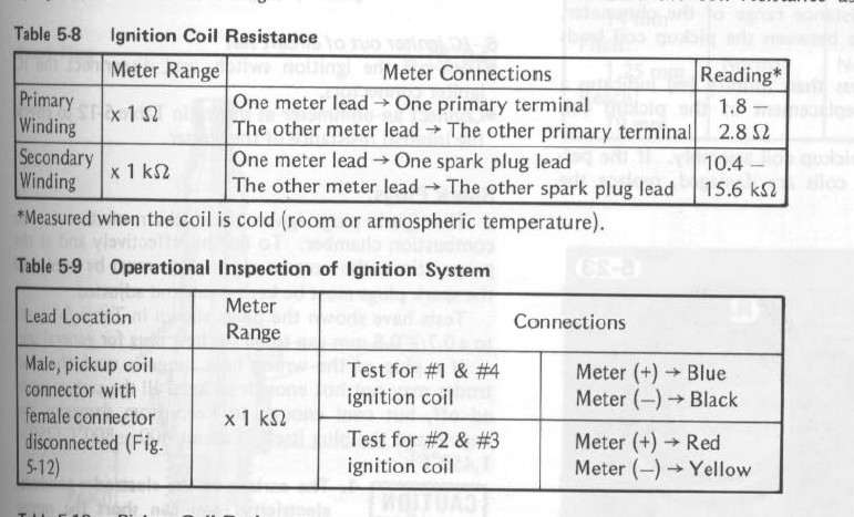

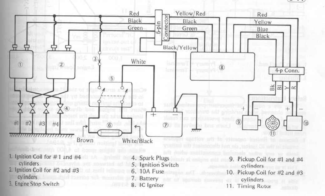

Post the Make and Model on the Meter, I'll Google it, and then tell you how to use it.
Also these are from my Factory Service Manual, although for a 1000, it is the same for yours.
You Tube has several Videos also on how to use a DVOM Meter.

Post up what meter you have, and we can tell you how to use it. But watch the video I posted, or check out some of the others on how to use a meter.
