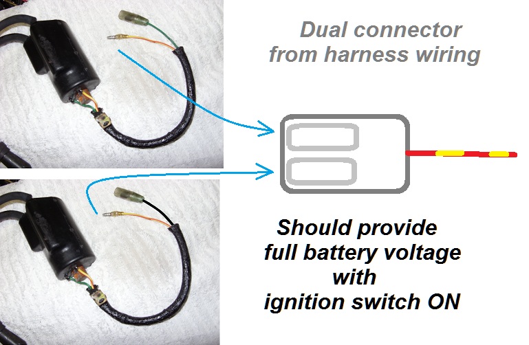

With fuel tank removed, should see a red-yellow wire going to each ignition coil.
The red-yellow wires usually come from a dual connector, that's easy to see and get to.
With the bike ignition switch ON, there should be voltage inside the dual connector.
Good Fortune! :)

Thank you. That picture helps a lot. I have a plug under the back side of the seat that is yellow with a red stripe that has the dual female plug on it but there is nothing plugged in it. There are 2 white wires also that have female ends and only one of them have a male end plugged in it. I hops my problem is something simple. I am on a pretty tight budget. Thank you for your help. I am going to step out and go take a look and see what I can find.
