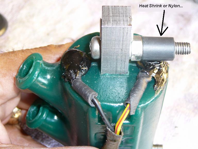

Due to 5-10 second time delay....
Dis-connect coil and Dyna ignition (+12Vdc) for T-shooting.
Turn ignition on and see if fuse blows again...
Also insure coil mounting studs are not shorting to grounded frame...
Heat shrink or Nylon spacers...
I'm thinking coils as they warm up with current flow is causing the blown fuse...
But hey, that's just me....

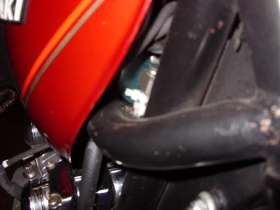

SOLVED!
The lack of power to starter/coils/etc was tracked down using the wiring diagrams and Patton's diagram. It was in fact the engine kill switch - was getting juice to it and but not from it. Pulled it apart and the contacts were corroded and shitty - cleaning solved this problem.
Now I've got power
Now I have to re-mount the coil so that the mounting bolt isn't touching the hot wire to the coil. This is what was causing my short.
OMR, what is that stuff on your coil leads, some sort of insulating goop?
Now I've got power

- Posts: 18564
- Thanks: 2103
Re: 76' 900 A4 blowing main fuse
18 Apr 2012 22:25
Here's one of several insulating options ---
When mounting Dyna coils on 1976 KZ900-B1 LTD, may wrap the stock mounting spacers with small nylon tie straps which serve to insulate the spacers from the heads of the screws used to attach the coil leads to the primary terminals. (See following pic.)
