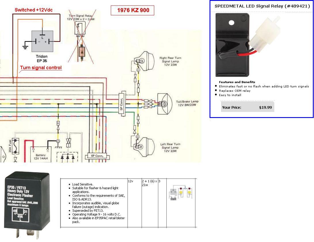

I have the EP-35 in mine, ~ $12.
The Speedmetal device would work as well..
As mentioned, load sensitive/LED low current relays are the way to go... Auto parts stores carry them for under $20...

Also good options, Rock. CWS wiring version comes with rubber mount that goes on factory tab of battery box, if it is relevant. Also, non load sensitive usually works better, the flash rate is consistent, with load sensitive, you will get different flash rates, depending on your application.
