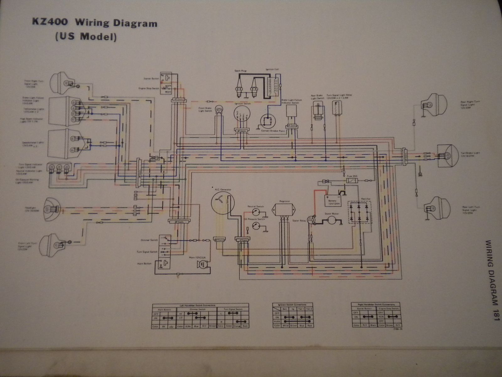

Does anyone have a wiring diagram for a kz 400 bobber. My wiring on my 400 project is just a mess. Doesnt seem that anything in my handlebar switches are working. Neutral light and oil light come on, thats it. I have jumped the starter solenoid and it turns the starter. I also bypassed the ignition and got spark. I would like to lose as much as possible, I just need something to go off of. I have seen some of the diagrams for other bikes with two coils, but just would like to see something for the 400. Thanks
