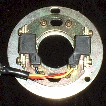

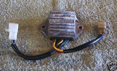

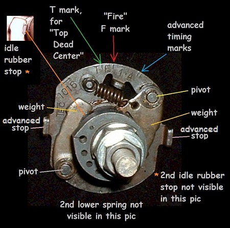

This is what the igniter looks like, that you want to use.
This is what the pickups look like.
This is what the rotor/advancer looks like (but without the hardware store bolt).
The factory electronic ignition coils look basically the same as the points coils, but are different inside.
