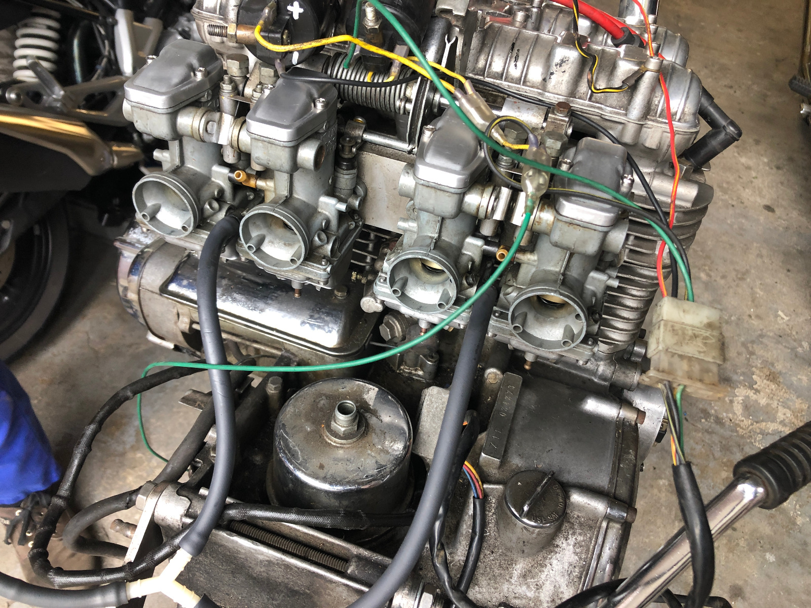

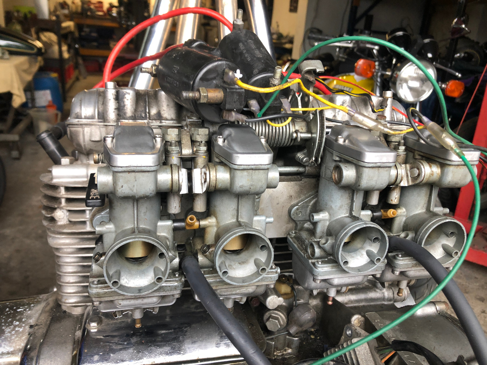

I visited my longtime Kawasaki-loving buddy again today;
he happened to have a 900cc engine set up on his makeshift test stand.
We hooked up my 28mm carburetors (I had already performed a basic static synchronization and set the float levels, with the idle mixture screws backed out two turns).
And—lo and behold—the engine fired up immediately on the second turn of the starter. After a very brief warm-up, it ran smoothly and beautifully with these carbs, both at idle and when the throttle was snapped open. A surprising and fantastic result. (There was a tiny bit of fuel seeping from the left T-connector, but it isn't loose; I think it will seal itself up again through contact with the fuel... otherwise, I'll replace it! The choke plungers also appear to be sealing well.)
Indeed, a NiZe-surpriZe !...I was absolutely delighted!
Now I can get to work cleaning up the exteriors of the carburetors a bit more and fabricating the adapters for the airbox... my plan is to have them installed and ready to ride by the start of the next biking season in March '27.
((On Sunday, we’re planning another nice 350 km ride to visit his brother; the weather is supposed to be dry, and I’ll be riding my black A2... it’ll probably be the last long ride of over 100 km for me this season.))
