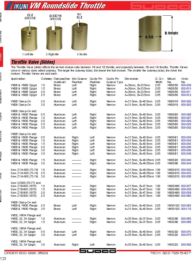

This is from the Sudco Mikuni Manual :
You have to take a slide out of your carbs and measure it, then see what may work. There are several OEM Kawasaki slides on that list.
Suzuki also used Mikuni, but unless someone with more knowledge on Suzuki carb spares speaks up that may be more of a gamble. I am not sure why only Kawasaki is on that list.
Mikuni quantify the cutaway size as fuel flow VS throttle setting.

Yesterday 07:41 - Yesterday 07:54Maybe someone on here might have spare slides at 2.0? That 1.75 was a custom part for the bike model tuning which can vary by model or year.Yes thats what I found !! Thank youu very much
Just found this stuff :
See some 28's at 2.0 and 2.5 cutaway.
I don't see any Kawi 28's at 1.75? Is it possible you have some Suzuki carbs? Maybe off a 750?
