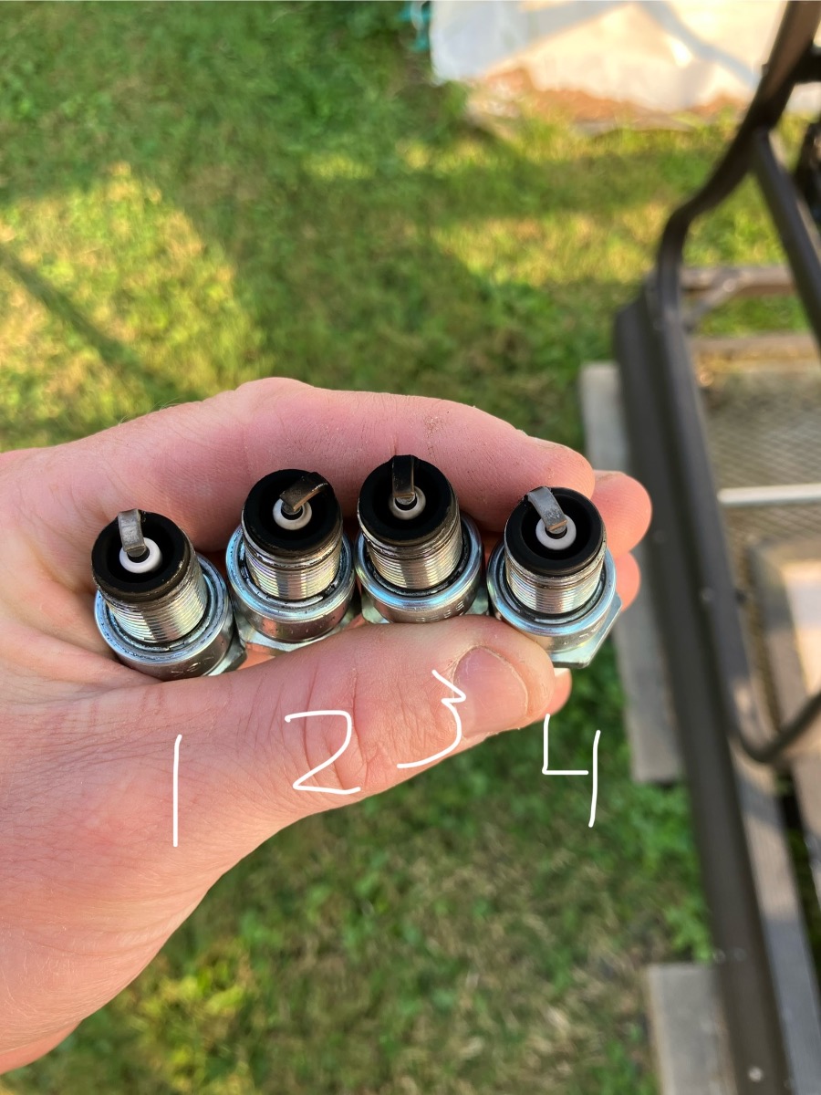

Good Day everyone, Im wondering if somebody has ever shim Vm carb needle one by one? Example. 1-4 one clip or 0.5mm richer than middle cylinders?! Just to compensate Pods airflow? Thank youu

Thank you.. so even if the middle one receives less air because of pods on 1-4 cylinders. I need to have the same set up on all 4 ?!  I appreciate

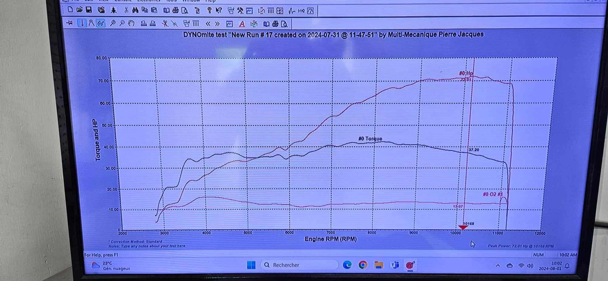

I don’t know how to correct my Surging 3000-4000rpm.. WOT dyno let me know that I’m at 16afr and drop to 14 at 5000~ rpm. 6000 I’m at 12.5afr !! I guess My cruise surging is because I’m lean. Maybe this summer my Real KN pods will help instead Chinese one?!

I know it's not cheap but a dyno graph (specifically of the AFR map) would point you in the right direction

So weak between 3500 - 4500 then rich 6000 - 7000. This would suggest main jet/needle profile but you need somebody cleverer than me to advise options.
