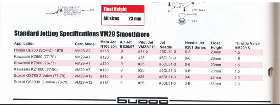

Ed, first there is this from ebay regarding the jet block gaskets, ( item 376490546198). Also this which shows all the gaskets as well as the jet block ones
www.joescarbshop.com/product-page/vm29-s...n-float-bowl-gaskets
As to a starting point for jetting instead of my attempting to make a suggestion, as I have not worked on a set of 29s in a very long time and it is rather hard to jet over the internet I will pass on some lists I have pulled down in the past. You may have already see these but below are lists from Sudco (some notes from wired George regarding them) and Z1 ent. Will also say there are, at least in my mind others here who have jetted them and may well be able to provide more than I can.
From Sudco
Application Carb
Model Main Jet Air Jet Pilot Jet Jet Needle Jet Float Throttle Valve N100.604 BS30/97 VM22/210 Needle #261 Series Height VM29/15
Honda CB750 (SOHC) -1978 VM29-A2 #115 .9 #17.5 #5DL31-3 0-8 23mm 1.5
Kawasaki KZ650 (77-79) VM29-A7 #120 .9 #25 #5DL31-3 0-6 23mm 1.5
Kawasaki KZ900 (76-77) VM29-A7 #120 .9 #25 #5DL31-3 0-6 23mm 1.5
Kawasaki KZ1000 (77-80) VM29-A7 #120 .9 #25 #5DL31-3 0-6 23mm 1.5
Suzuki GS750 2-Valve (77-79) VM29-A12 #115 .9 #25 #5DL31-3 0-6 23mm 2.0
Suzuki GS1000 2-Valve (78-79) VM29-A12 #115 .9 #25 #5DL31-3 0-6 23mm 2.0
Float Height
All sizes 17mm
from wiredgeorge
If you are looking for a good laugh, find Sudco's VM29 jetting recommendations and try them out. HUGE main jets, HUGE pilot jets and the air screws cranked out way too far. When I first started jetting 29s, I tried following these guidelines but guess what? hehe
The 29s are VERY VERY similar to the 76/77 KZ900A/B VM26s... same needle jet size, same jet needle size, same slide cut out and the main and pilot jets should be REAL close. The 76/77 VM26 was a bit too rich when back in the good ol' days, the EPA didn't notice. Those carbs will allow a bike to start with little or no choke and you can change to most any pipe without a flat spot.
Air screws on 29s don't behave the same way as on other VM series carbs because of the hole in the screw towards the tip. 1/8 turn out is about right for #17 pilot jets. If you are not fouling plugs then you are not too rich... (pilot circuit)
From Sudco
Application Carb
Float Height
All sizes 17mm
from wiredgeorge
Ive been thru Sudcos jetting , that why I ended up where I was but it didnt seem right with that idle mixture screw setting. Sure glad you straightened me out on it. I noticed that you could put an open 4-1 on a stock set of 76 carbs. To me they run as good or better then the Z1 28 VMs. Thats what I had on the bike before I got the smoothbores back in the day when you could buy a set for $100. Thanks again for the help.

I am sure you have seen this before but thought I would post it just in case :
I believe this jetting assumes a pipe/pods (race)
What they don't give you there is the pilot air jet setting but that depends if it has the stock air screws, which have a tiny hole in the tip ends that lead to a cross drilled hole. Some owners replace those with normal VM air screws or solder up the holes. With the stock air screws you will find 1/8 turn out as a good start up point, I think max adjustment is 1/4 turn out (not like regular VM)
As for the jetting it may be safer to start it with a #125 main then do a plug chop.

Start with the 25 pilot and a 130 main which should put it on the safe side of the ball park.
Also these 29's come with 0.9 main air jet ( air corrector jet ) as stock which will likely end up being closer to 0.6 once set up..

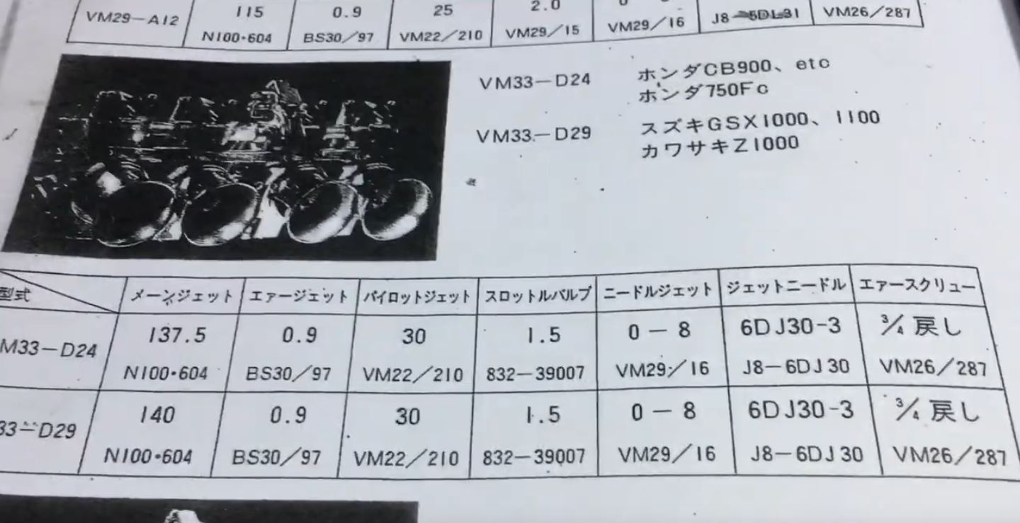

Most listing I have seen with VM33's for most engines above 1100cc show a pilot jet of #30 and main jets of #130 to 140. Gas mileage on a 1200 with hot cams will not be great especially with a big pilot and main jet.

No turning back now on the VM29's...
We'll jet accordingly.
Problem one, can't find Jet Block Gaskets. I can cut some, but any suggestions on gasket material? It's paper thin. Sudco's exit is causing pain...

22 Jan 2026 17:34If your referring to the Z1/KZ900/KZ1000 jet sizing as far as "#25 in later version" means KZ1000.Nessism post=920872 userid=14026How to know if these carbs are "the later version?"
You also have to watch out for the fact these carbs don't have overflow pipes. Suggest to run lines on the vent nipples behind the engine, so if a float hangs up the gas will not end up on top of the case.
