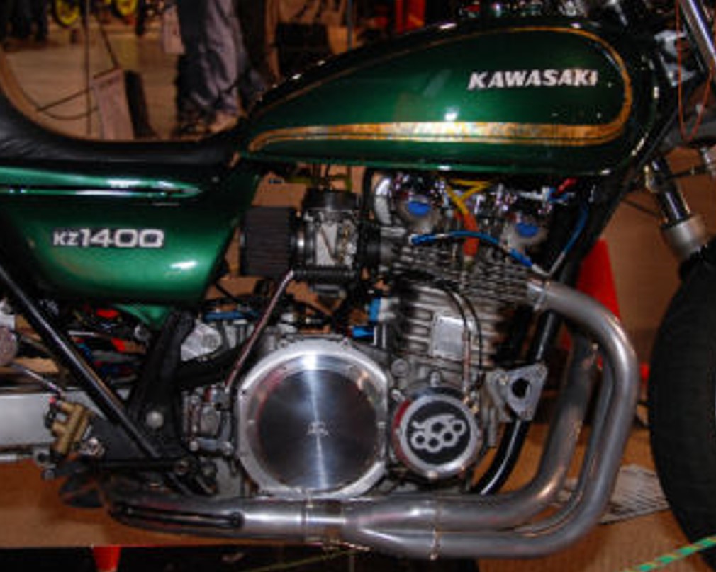

I was also looking for some carbs for my 750 engine swap into my KZ650 frame since the motor did not come with any carbs. I considered OEM style CV34's and some even the RS34's I already had. I ended up using some CVK34's I bought cheap from a 1990 Ninja 750 (not sure if this is the same swap as the CVK32's)
The CVK's are more performance orientated than earlier CV's because they incorporate a hybrid "flat slide" design which gives better fuel pickup and increases CFM potential. All CV's have way better low speed mixture as compared to old round slide carb designs.
From noting these improved design considerations I would not doubt a set of CVK carbs could handle any high performance upgrade you could throw at them (cams/porting/big bore etc)
I have even seen CVK's on a 1428cc KZ based Pro Street bike at a local bike show :
