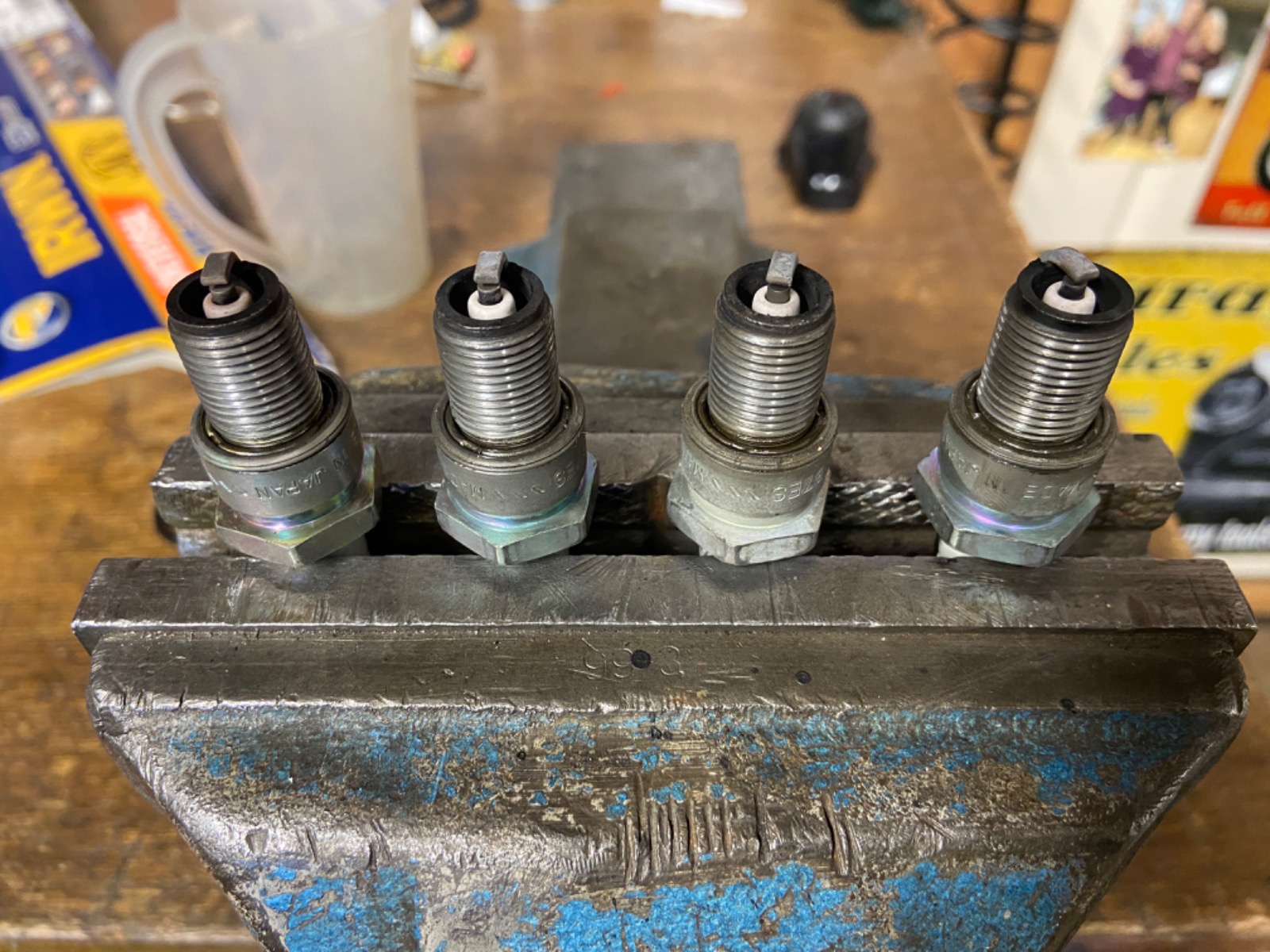

If it was an air leak I’d be experiencing a lean mixture not rich.
Anyway below is tonight’s plugs after a 60-70 run home from my local bike meet, airscrews 1-1/2 turns out.
If I could resolve the startup issues I would be happy….inlet manifolds are perfect same as air box rubbers.
2, 3 & 4 are lean. Screw your airscrews in 1/8 turn on those three.

Have done... thanks everyone for the suggestions, I'm still amazed dropping the fuel level could make such a vast difference,
