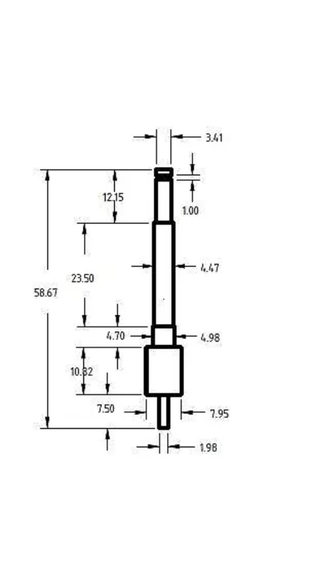

Hello guys, does these Choke plunger fit on the vm28ss carbs? There were Niche plunger, the seller tell me that ; eBay item number: 162890295846 Genuine Mikuni VM29 VM33 Smoothbore Starter Plunger Valve VM24/510

Thank youu, but your plunger doesnt have the nipple at the bottom ?! Vm24 are similar at vm28 but I dont know if they fit..

The site jetsrus has Vm24 plunger !! When someone confirm me that they fit, I will order them

The ones from Niche fit the VM22,24,26,28 and smooth bores.
They are genuine Mikuni but reproduced for the Japanese market and in particular the classic kawasaki race series and don't have viton seals so are not ethanol fuel resistant ( which is the case with all pattern plungers ) which is fine if you have the option of running ethanol free fuel but won't last long if you don't.

Thank you Zed, again!!! Does this oring size can fit on my old plunger 6.75mm (od) x 2.1mm (id) x 2.15mm (thick). ?!

The plunger seals are not 'O' rings.
They are flat lathe spun discs and not available as a seperate part.
The ones i fit are custom made by myself to the exact dimensions of the originals from 75 shore viton to fit each individual plunger.
The VM/SS (16016-021 plunger type ) blanks are 2mm thick with 2mm hole and 7.4 mm diameter with a 40 degree chamfer on the perimeter of one face to conform to the underside of the plungers swaged brass retaining edge.

So even of I put a Seal/oring it won’t be good !! Thank youu
