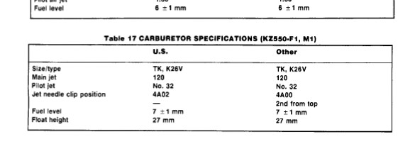

My bike will start then die after a few seconds. It then wont start again until a few minutes later. If i turn the choke on it will idle very high (7K rpm) and die as soon as i shut that off. 1984 GPZ 550. Bought it not running and sitting outside for awhile. Took everything apart on bike for cleaning/replacement outside of engine (had extra one from previous parts bike that worked well 1985 gpz550). I am trying to get it running for the first time.
Things I have tried:
-Checked spark plugs. Little fouled. Good blue spark at each.
-Have auxillary tank hooked up with clear tube so i can see good fuel flow. Check fuel at each bowl as well.
-tried removing air filter, but did not help.
-checked resistance on pulsing coil plug (not sure if i have anything else to check on 85 engine?)
About fuel system:
-TK26 carbs, non pilot plug
-Main 120
-Pilot 32
-Air adjustment screw set to 1.25 turns out
-butterflies bench synced with paper a piece of wire
-floats set at 7mm +- 1mm
-brand new cmsl stock airbox
-the four vacuum ports are plugged for gravity fed fuel source.
I have been able to revive a couple bikes in the past but this one has me a bit stumped being that the plugs get fouled and damp but the choke keeps it running but at a very high rpm. Let me know if you have any ideas.

I dont know your carbs fuel level spec but are you sure it is right? 7mm sounds like alot.And about the 4 plugged vacuum ports.Does the petcock have a vacuum opening if it has and there is no vacuum hose from a carb plugged in it it will shut off fuel .

25 May 2024 13:07
#899721
According to Kawasaki service manual.
